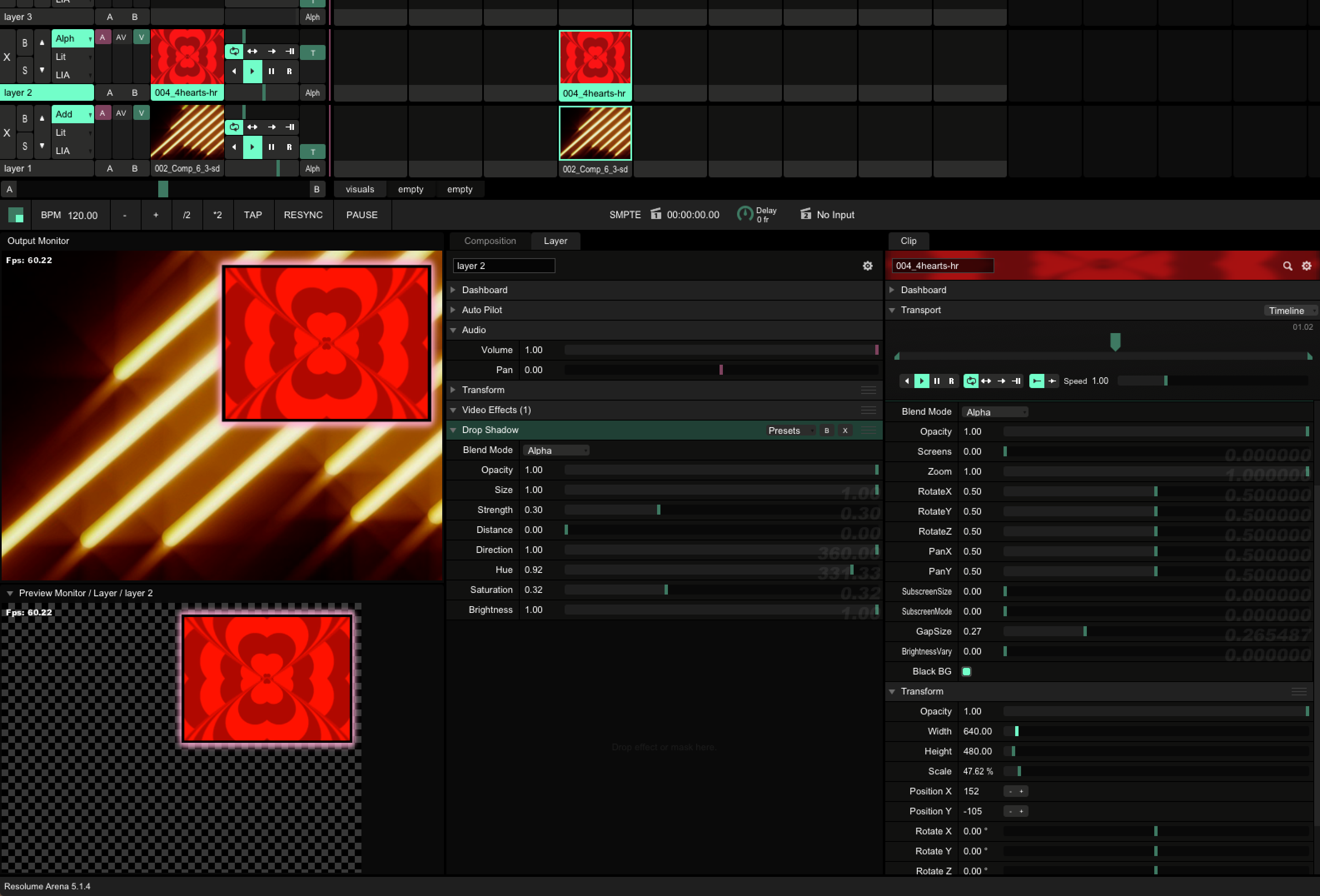

You could do this with a videowall effect, screens set to 0, blackBg On, zoom set to 1, and gapsize to >0 on the clip before transform,
you resize and position with clip transform, and add the drop shadow effect on the layer after transform.

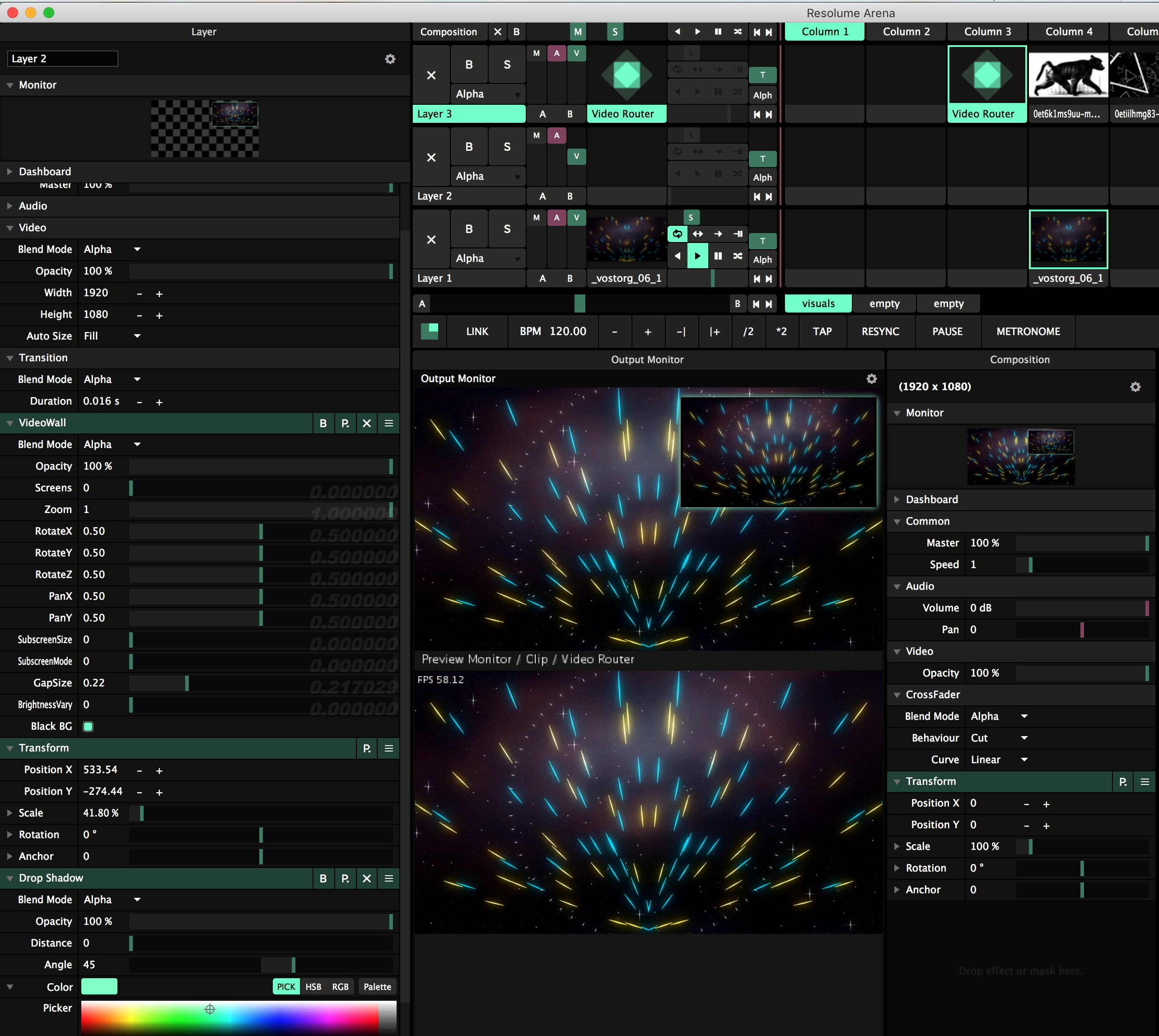

Much simpler in R6, just put the videowall effect on the layer, before transform, and the drop shadow after transform.

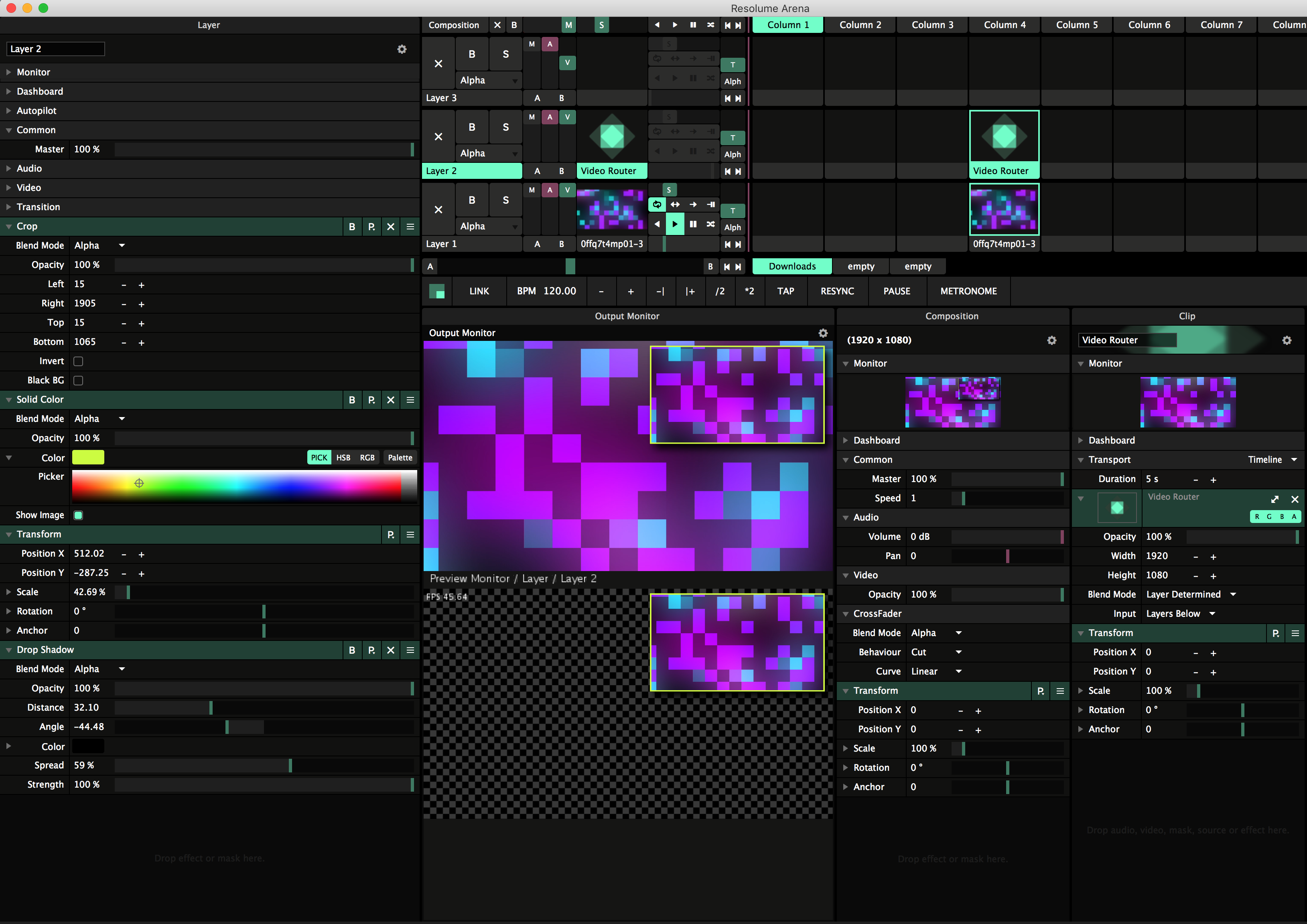

In Resolume 6 you can do a setup where you can color the bounds, if you don't mind losing a few pixels of the original image.
on the layer:
- crop effect, set to 15 pixels each side,
- solid color effect show image enabled,
- transform effect to place and size where you want the overlay,
- drop shadow effect to finish up.

update : tested it, and it works great! thanks :-)
