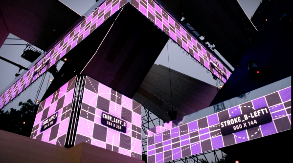

How resolume can generate exp files ?
Post by FabS »
Like that : https://ibb.co/iJzxOR ??
(from resolume 6 teaser)

Export input maps as SVG, import to after effects and use this script.
http://www.dvizion.net/led-pixelmapper-ae-template/

and after, i need to reimport the files into resolume ?! so much manipulation :/
Re: How resolume can generate exp files ?
I think what you're looking at is pretty simple to create using the advanced output:
  • 1) Create as many screens/slices as you need for your setup
    2) For each slice, select the area of the composition in the input selection
    3) Adjust each slice to match your LED screens specs
    4 Use your creative content and I believe that's it
Here is a little video to explain the basics:

This Test display is more efficient in resolume 6, nice.
Better than arena 4 & 5 :)
thank you for the video
Does that answer your question?
FabS
Posts: 13
Joined: Mon Jan 30, 2017 23:38
Post by FabS »
Yes that's okay, i will create a personnal EXP file and will slice them ;)
thank you
