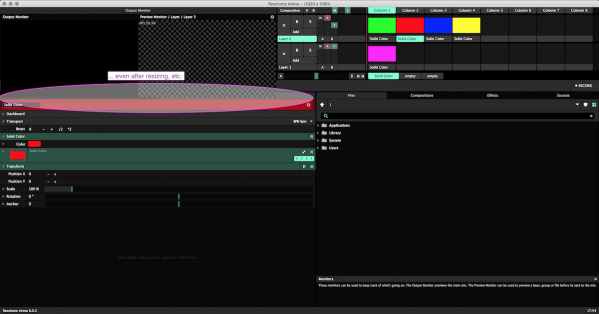

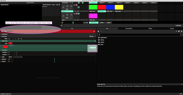

Moving the Monitor panel around and resizing it causes other panel titles to be hidden. See attached 'titles of panels below are hidden from view 1.png' (please ignore the highlighted square box in the middle, it's there by accident) and 'titles of panels below are hidden from view 2.png'.
Preview monitor size settings are not retained when R6 is restarted (although the titles of other panels are then correctly shown). See attached 'after restart.png'. Unfortunately, I made the screenshot after resizing, so it doesn't show this and I'm too lazy to redo :D , but when R6 is restarted, the Preview Monitor is a lot smaller than the Output Monitor while they were the same size before restarting R6.

Seems odd.
Can you recreate this, starting from the default layout?
If so could you send us a screen record or the steps to do it?
Does the Monitor panel get sized to the correct size when you resize the Resolume window?
Also if you get into this state, please save and share the layout file with us, so we can take a look.
