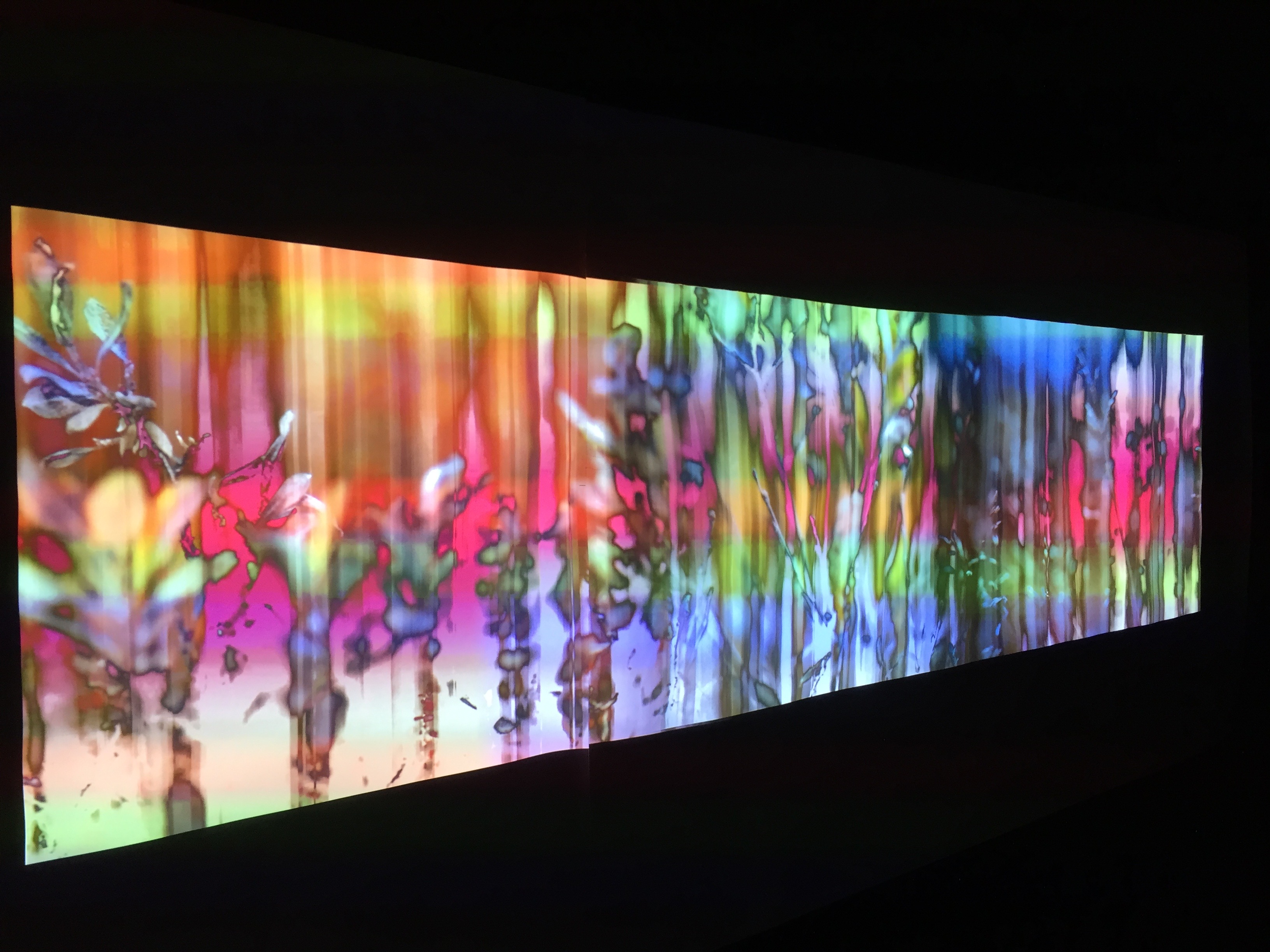

Hi there Francoe. Thanks for letting me know. I fixed the link.
What I have used brightness/contrast for is that it treats black as alpha, so if you have two video layers everything black would be transparent.
Here is an example image of 2 layers of video. One static with only background colours and the other of some flowers/trees.
Thanks for trying to help me out. I really appreciate it.

Ok. In fact, your code is taking values from green channel and assign it to alpha. I will check how to improve it (you can see right now is just making the whole thing semitransparent, needs to ramp the values).
Are you aware that you can have that using the blend modes, right?
Lighten, Luma is Alpha and Lumakey can be your new friends. :D
