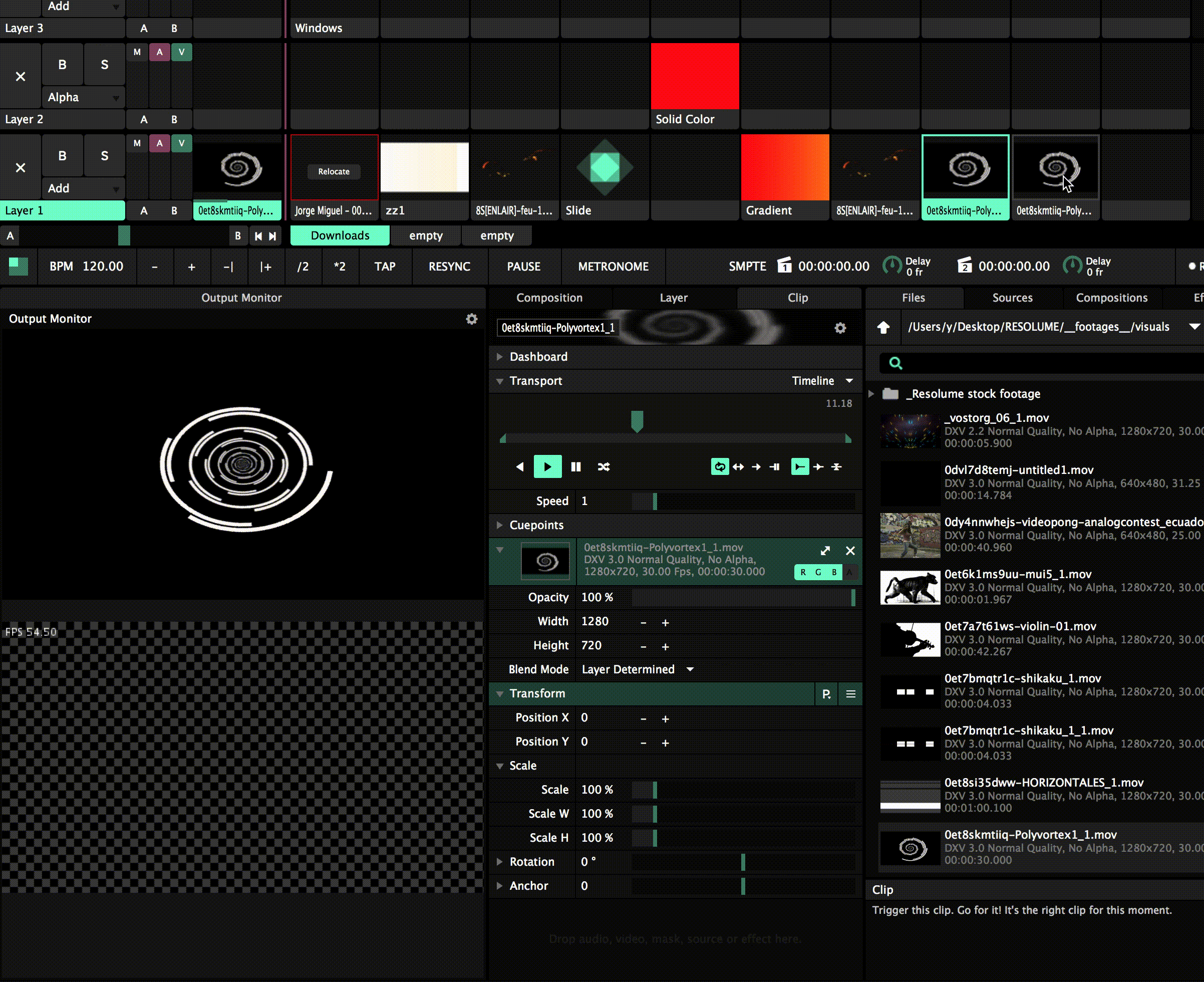

For General parameters like positions you can set the parameter in/out points.
You can either set the parameter to timeline and pause
or assign the parameter to dashboard dial
to get the parameter end points.
Adjust them to the range you want your parameter to be controlled, and the DMX input you send should cover only that range.
This will give you more precise control, but it's still 8 bits.
Is your show pre-programmed?
You could create the automations for movements in Resolume using Envelopes and timeline parameters on duplicate clips.
The original clip would be static, then when you want to move it you'd launch a duplicate of the clip with the parameter automation, and the clip's play mode set to Relative
