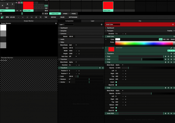

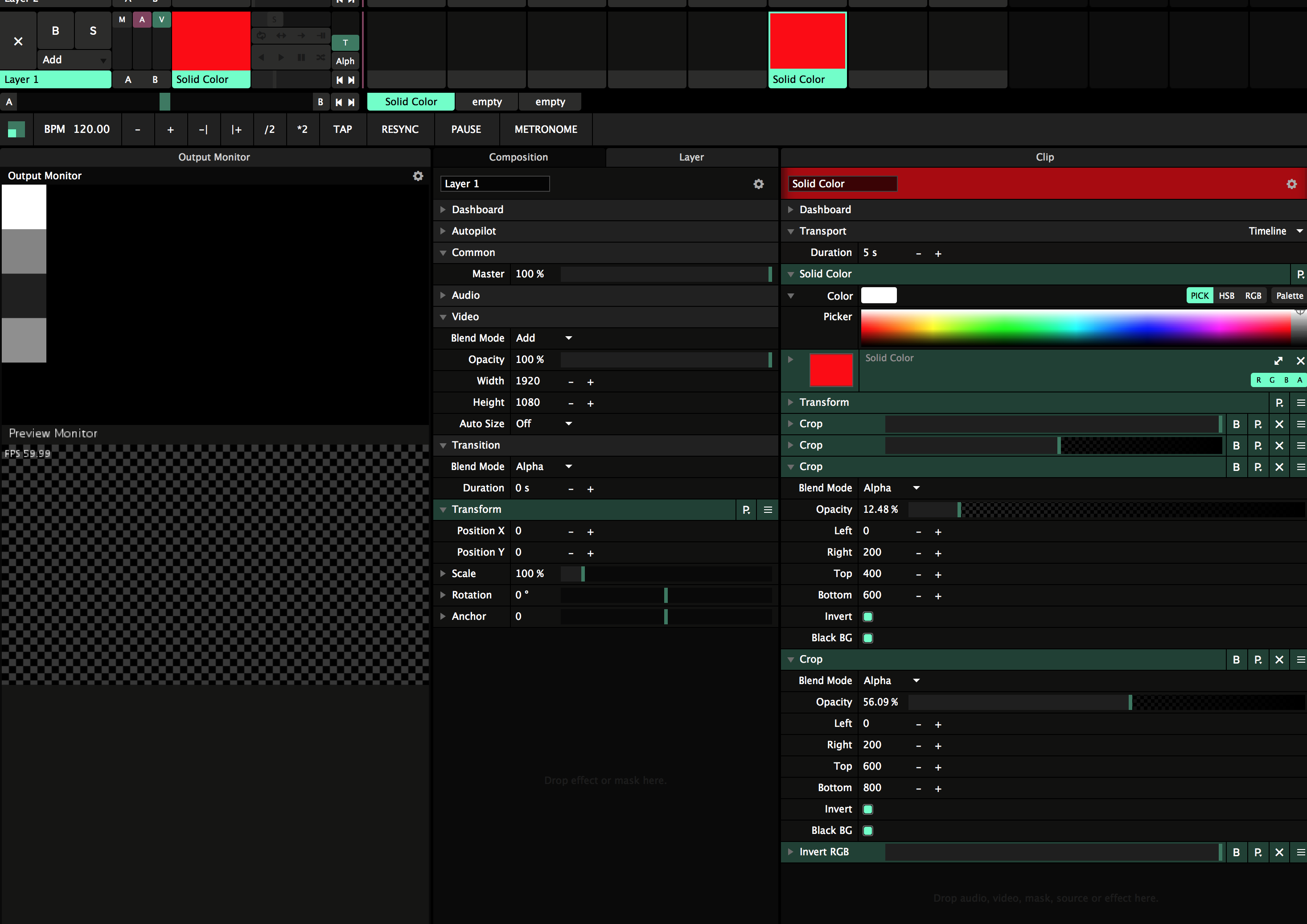

A single solid color clip with come crops, and and invert RGB
Change the crop effect opacities to change the white level.
