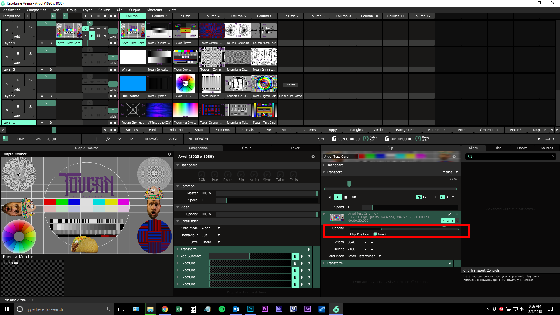

Here's a picture of what's been setup on the clip:
Basically, when their clip is loaded, the video starts off black for a half second then comes on, all the while, the audio starts off normal. The video doesn't kick in, out of sync, everything is still in sync, it's just making the video go black before going to 100% opacity when they set the opacity modifier fx to "clip position"

With these settings, I'm expecting the clip to be at 100% opacity at the start of the clip, then go down linearly to be at 30% when it reaches its end. Is that not what you're seeing?
Re: Playback with reverse opacity FX
That's what it should do in theory haha.Joris wrote:With these settings, I'm expecting the clip to be at 100% opacity at the start of the clip, then go down linearly to be at 30% when it reaches its end. Is that not what you're seeing?
When the clip is triggered, it goes black for half a second THEN goes to 100 down to 30. The audio still comes on instantly when the clip is triggered, but for that half a second there is no video to accompany the audio.
If you need the specific video file that's causing this (DXV3) I can try to get it to you later tomorrow (Client is in different time zone and I typically can't remote in until about 10pm)
