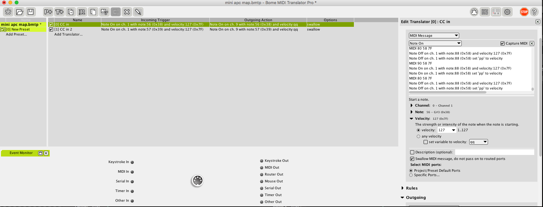

I tried re-routing 2 notes/buttons on the Mini APC in Bome so that they would be translated to MIDI channel 9. I'm not sure if I have done it right though because resolume isn't responding to any inputs from the translated buttons.

You have to open the ports in your settings and select bomes in Resolume.

Oh yeah I see now thank you :)
