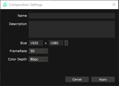

Did you try locking your composition to your chosen framerate?

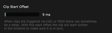

The other trick you can try is to set the clip start offset in the general preferences to 9
Even if you don't trigger the clips with any midi or osc device it makes a difference in how clean a clip is triggered from the beginning. + do all your testing from you internal SSD

MS offset didn't do anything!
