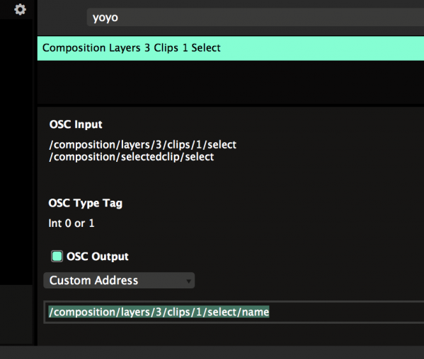

Hello,
I´m using touchosc and i´m creating my personal patch based on Diego Battini greatest one.
I´m with Res. 6 and i´m converting all my buttons to OSC language.
However i have a problem with the names.
I try a label and put the osc code: /composition/layers/3/clips/1/name/ and /composition/layers/3/clips/1/name/?
and i already could get the name on tablet but just when the EDIT OSC on resolume is oppen and with OSC output enable to just a single clip. So, it´s a bit confuse and basicly my question is:
Wich code i should put on TouschOSC Editor on the label and if is needed do something on " EDIT OSC" on Resolume.
The attachment Captura de ecrã 2018-06-15, às 14.38.10.png is no longer available

Unfortunately not. I´m trying have for example the name of the clip in one label on my tablet. For example i have one button to activate the clip and i have also a label where appears the name of these clip. Do you know witch osc code i should put in the label on TOUCHOSC EDITOR

rjap wrote: Fri Jun 15, 2018 14:39 Hello,
Captura de ecrã 2018-06-15, às 14.38.52.pngCaptura de ecrã 2018-06-15, às 14.38.10.png
I am having the same issue. The name only sends to the tablet when the osc Edit function is open on R6. Once you close it and trigger the clip, the name on the tablet changes to a numeric value.
Have you found a fix for this yet?

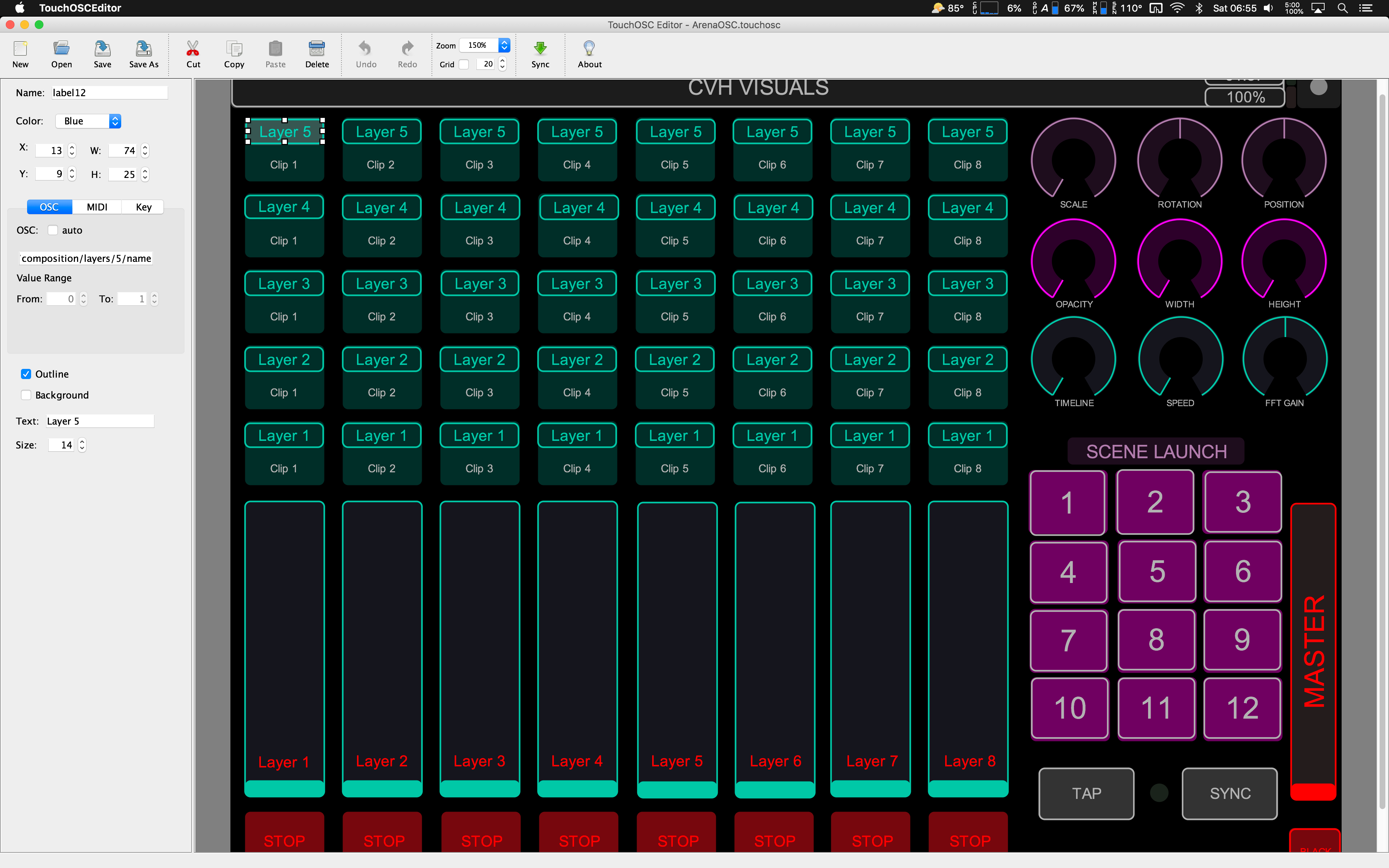

cvanhoose
Posts: 277
Re: OSC - Feedback problems
Post by cvanhoose »
My address is linked to the text fields on top of the buttons. Layer and Clip
Thanks in advance,
Chris
