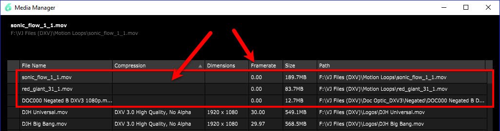

I have been using the new exporter for a bit and Resolume Media manager to clean up some sins of my past. Some of my newly re-encoded clips are coming up missing Codec and Framerate specs. Just empty fields
Any ideas? I know they are right as others in the batch come out fine.

So some of the files were DXV 2.2
The others said "FFMPEG Audio Decoder" in Media manager originally. But Alley is saying the original source files were DXV3 already. I was not thinking a DXV3 file could say "FFMPEG Audio Decoder" in Media manager. So I originally trashed the ones in Resolume and re-encoded the originals. I obviously do not need to re-encode DXV3 files.
Does this mean there are issues trans coding DXV versions?

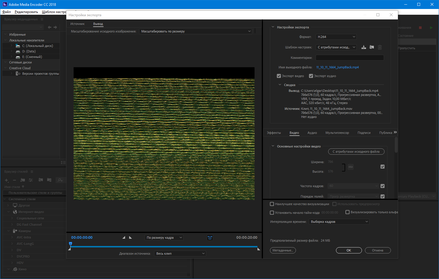

DXV 2.2 looks corrupted into Adobe software with Resolume DXV3 importer.
That's file, encoded in DXV 2.2
https://1drv.ms/u/s!AiUh7dQ0EGg9iddpfkQAHKXle-YtDg
Re: Adobe Media Encoder issues
I get the same results you are getting. Tried multiple programs. Have a feeling it's the file.
It's weird that it plays back normal, but when AE, Premiere or AME touches it, it get's all garbled.

If you have Adobe suite below CC 2018 and delete DXV3 importer plugin, it will be displayed correct into Premiere, AE, etc.
Posts: 7705
Looks the same on my side.
I'll create a ticket. (#11428)
