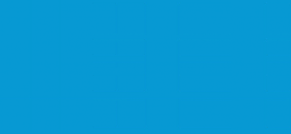

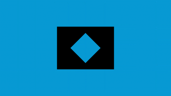

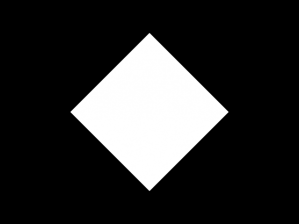

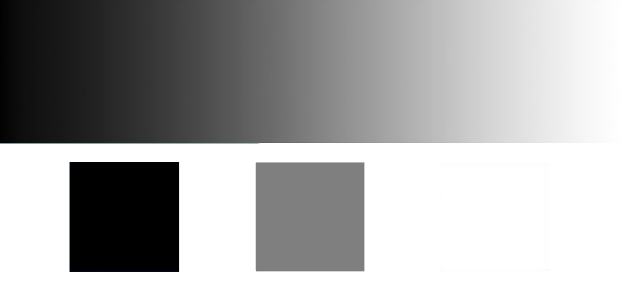

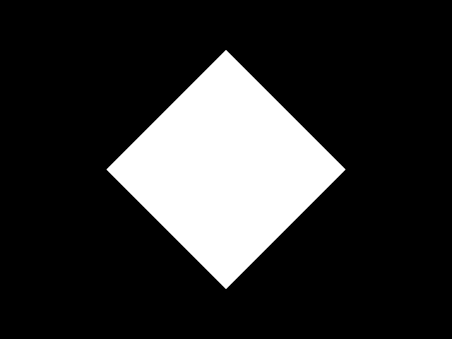

Since screen is the opposite of multiply, are you experiencing any issues with transitions involving the screen blend mode or is it working as expected?
At 50% screen, results are exactly as expected and if I eject the clip on a timed transition, I get a nice smooth transition to my bottom layer. In 50% screen, black and alpha are treated equally which is right.
At 50% multiply, results are as expected except that alpha is treated the same as black when it should treated the same as white and reveal 100% of what's below it.
Now because of alpha being treated as black instead of white, at 1% multiply fully covers what's behind it instead of almost fully revealing what's below it so it seems that by treating alpha as white instead of black (the opposite of screen) 50% multiply would work as expected as a blend mode and during transitions. This would match the result I get in Photoshop, After Effect, and other media softwares I've tested.
As a note, I tested with Arena 5.1.4 and the transition with a 50% multiply seems to work as expected but the blend mode still treats alpha as black which is not correct.
I'm attaching the layers I've been experimenting with and the result I would expect to see with the multiply blend mode.
My $0.02!

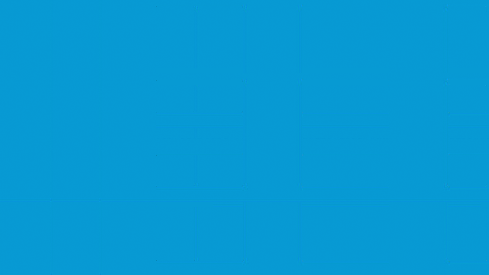

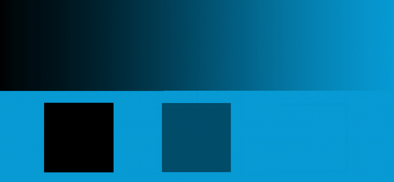

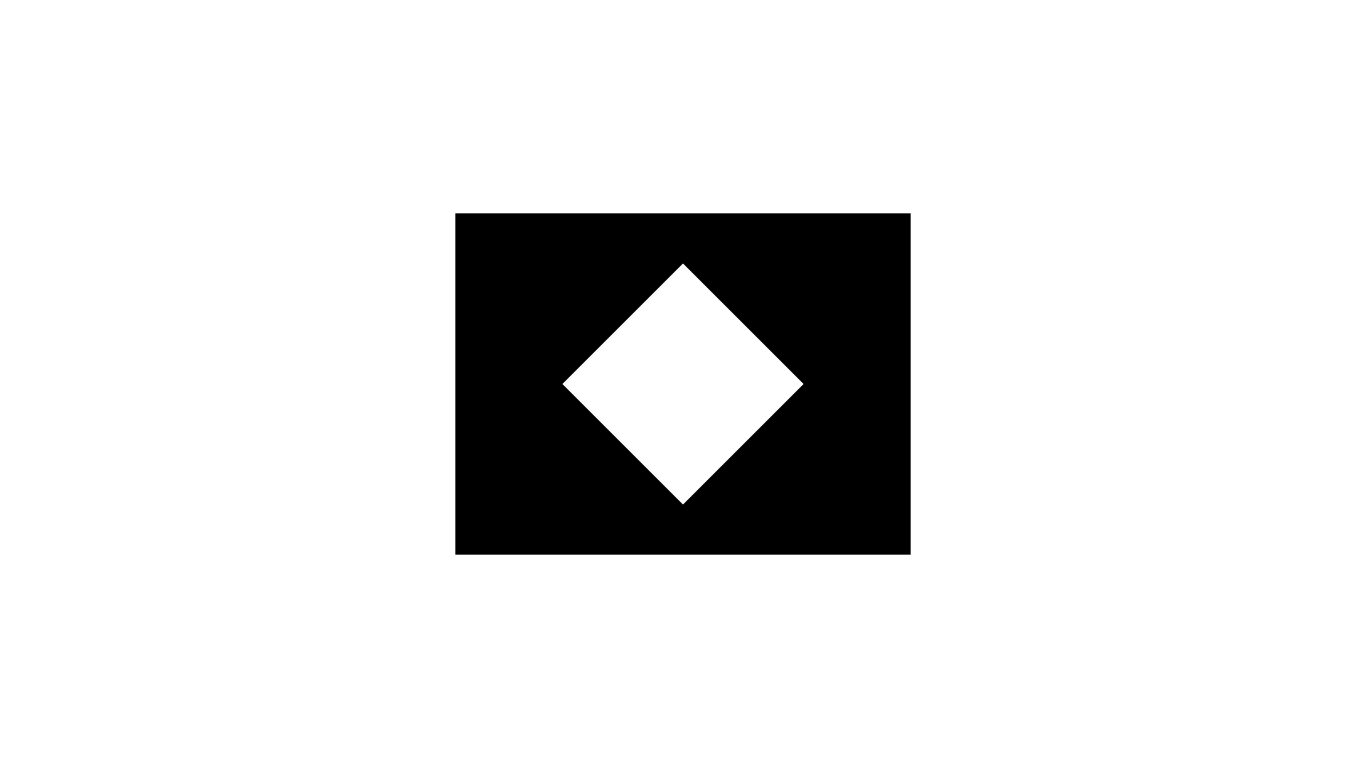

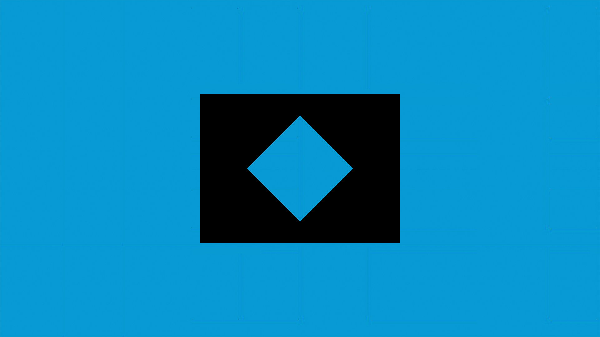

Re: Arena 6 multiply blend mode fade problem
Interesting. Treating transparent pixels as white in a Multiply blend (or doing no pixel operations at all, same thing really), would mean case 1 and 2 are visually exactly the same, so there would be no cut between them.
This will give the result that cropped or smaller res clips used in a multiply blend, will reveal the layers underneath at the edges. Are you sure that's what y'all want? Ie, if you use the attached file at native res to multiply 1920x1080 content in a 1920x1080 comp , what would you expect the end result to look like?

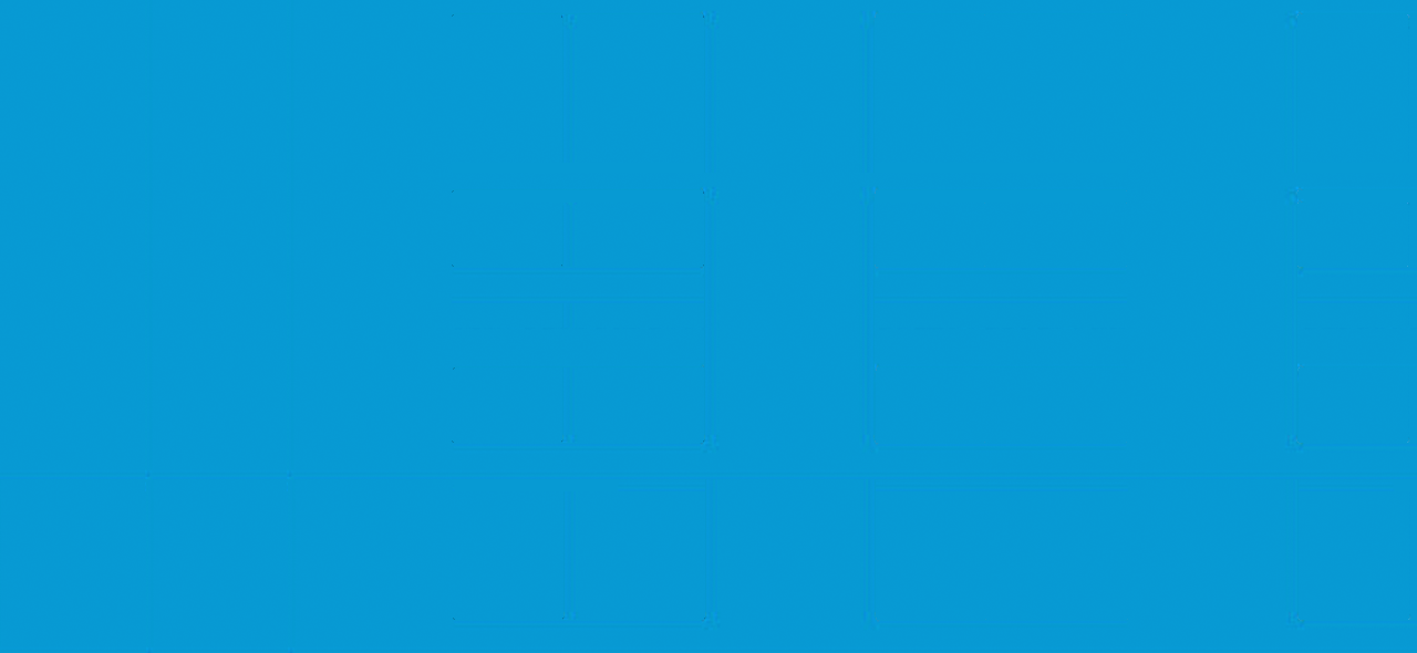

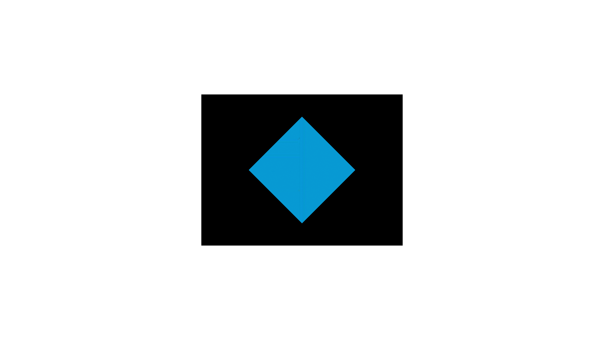

I would personally would expect the same result I get in photoshop where 100% transparency multiplied by a color below yields the color below:
rather than 100% transparency multiplied by a color below yields 100% transparency:
I'm sure opinions will be divided so maybe it would be good to have both available! That would also make working with artists who design content in Photoshop easier when they give me artwork to use in multiply layer.
