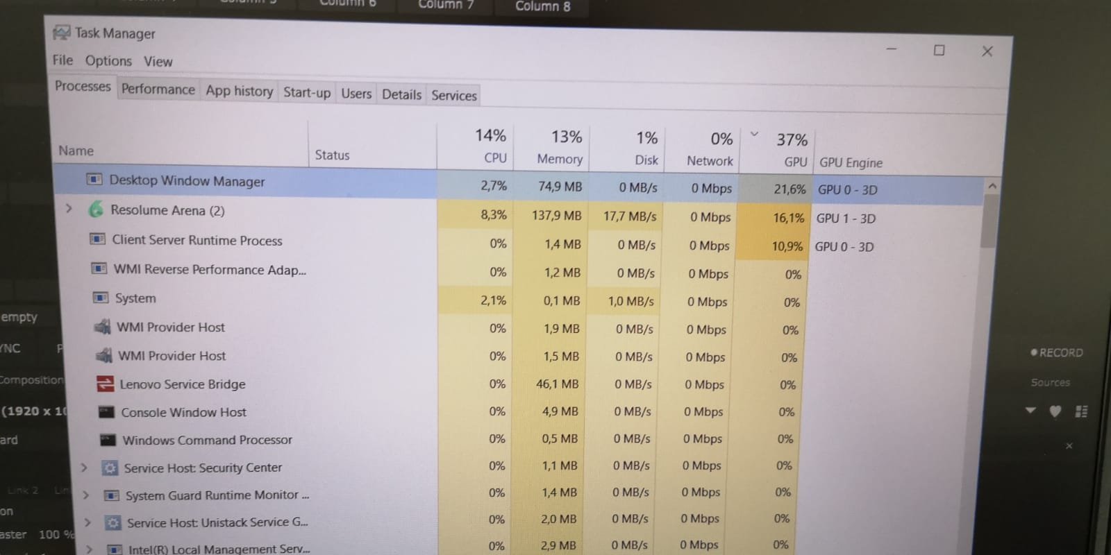

Now resolume is doing not that great. One 1080p50 DXV clip, 1x 1080p50 output on hdmi, framecounter is showing 50fps, but during the clip it drops sometimes to 30, 35fps... Strange, because I've tested the same model with a 1050 (non-ti !) and that was solid at 50fps.
Now I was looking at windows task manager to find what's going on. I found Desktop window manager is taking quite some resources. When I close resolume, it goes back to idle like all other system processes. Screenshot/picture:
1. Does resolume need this process?
2. Why is it taking so much resources?
3. Could this be the cause of dropping framerate?

Hello Hans,
what nvidia drivers version do you have? If above 4xx.xx try to install previous 398.xx or around.
I also had problems with newest drivers and had to intstall 398.35
Re: Desktop window manager VS resolume?
I am running the latest (as mentioned), so yes somewhere above 400.
