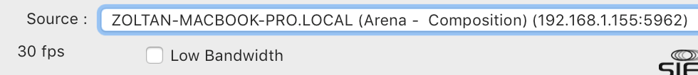

Sienna NDI monitor shows the correct FPS for me if I set my composition to 30FPS.
Could be a bug in the newtek app? probably not,
It shows it's a 60p source for the same signal.
Posts: 7800
Re: NDI deinterlace?
So it looks like, we explicitly tell the NDI Stream that it is 60fps.
However when you set the composition frame rate to 50 (or something lower than 60), then there are actually fewer rendered frames. Only the rendered frames make it into the NDI stream, so with a composition set to 50fps, your stream will contain 50 frames per second, even though the stream is set to 60.
Looks like Sienna Monitor counts the frames, NDI monitor and Vmix is relaying on the stream flags.
