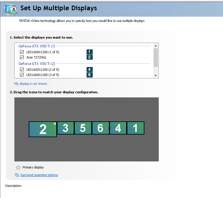

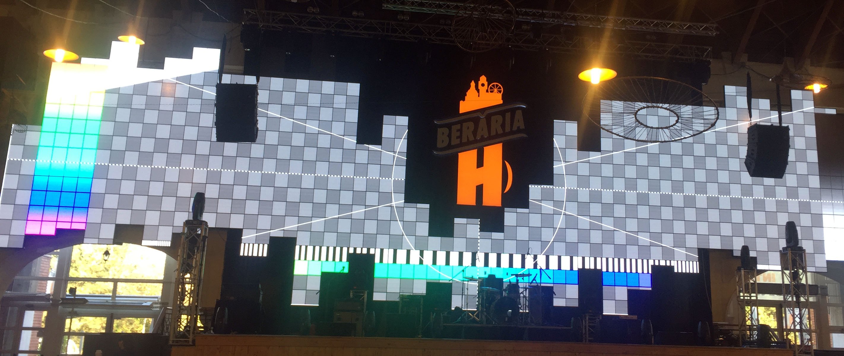

Got some stuttering issues with this big screen I just installed
We are using 5 led control cards for it.
The first video card (gtx 1050 ti) outputs to 4 led cards
The other one (same model) outputs to the last led card and my monitor

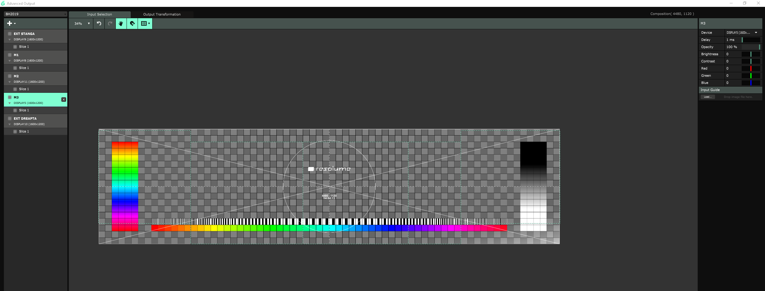

I used Resolume's advanced output to map the videowall through the multiple video outs
Composition size is
4480 x 1120px @ 30 fps
I'm seeing small stuttering between the outs of the card controlling 4 led cards (barely visible but not completely fluid), and big stuttering with the other card controlling the last out and my monitor.
Here's a video of the problem

Hi zone_nord,
what you discover is a framesync problem. Your big sync discrepancy from out 1 can only be solved if you move it to the other outputs (Out 3-6) on the other 1080ti.
But, I guess you have no more outputs left. So then, you should try to run your whole setup (4480x1120px) with 3x 1920x1080 from one card. Yes you have to rewire and remap.... but thats your only option now...

- yeah the whole screen has identical leds and controllers
- I had no hdmi outs left on the secondary card to connect everything there but I'll use one DVI-DVI to do it (didn't have the cable there to try it)
that would probably temporary fix it till' I manage to cascade the led controllers so I could use just one video out as a big screen (or at least half of it)
Re: Multi-screen stuttering problem
Keep in mind that even though your card has five connectors, it only has for outputs!
