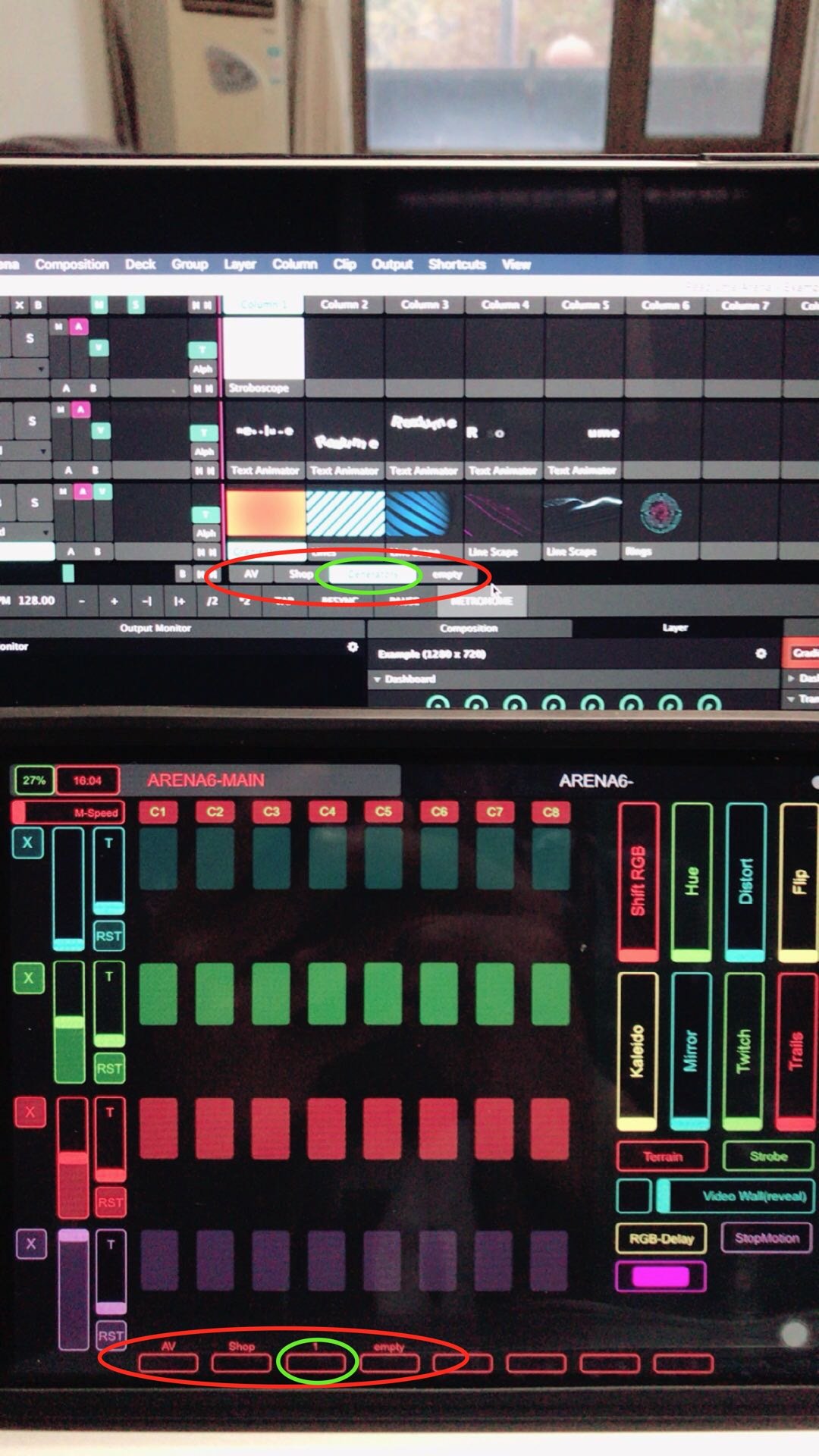

I made a tamplate for arena 6, use /composition/decks/1/name address to get deck name(or clip name),but the thouchosc can't display the right name, at the beginning, the name is right, but when I click a button, the name change to number (1 or 2 or 3 or 4).
and the /composition/selectedclip/transport/position just active when the clip preview was clicked.
the same template run with avenue 6 is perfect for my friend.
touchosc feedback display error

which button do you click.?bloodywing wrote: Fri Nov 16, 2018 16:13 but when I click a button, the name change to number (1 or 2 or 3 or....
Could you share the OSC preset you use, the touchosc template and the composition file?

At the beginning when i run arena and touchosc (Sample project ), the name can be right, then i click a deck button (Or clip button ), the label will change

Ok, could you share the OSC preset you use, the touchosc template and the composition file?

the poistion fader had problem tooZoltán wrote: Mon Nov 19, 2018 10:12 Ok, could you share the OSC preset you use, the touchosc template and the composition file?

Ok, this is so far only the TouchOSC template.
Do you also have the OSC shortcut preset and the composition .avc file for us?

I use the arana demo samplp.avr

No special settings for shotcut. Only open some shotcut output to sync touchosc fader's progress bar.
