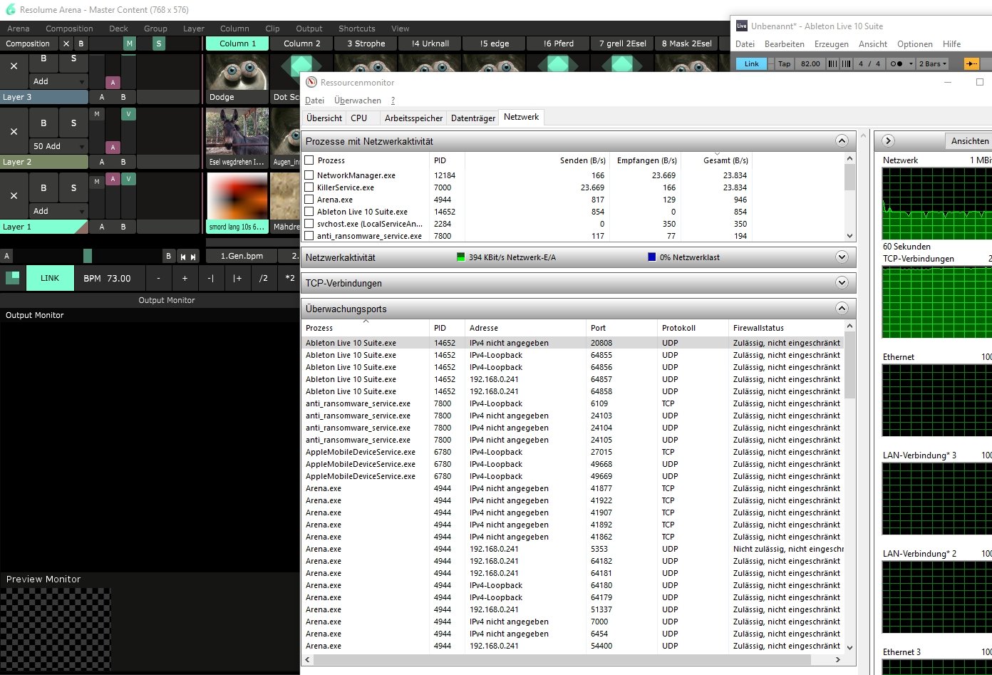

I open Resolumen and Live (I think it doesn't matter which is opened first), enable the "Link" button on both and see that it doesn't work. There should be a "1" in the Ableton Live link button, but Resolume is not linked. The tempo doesn't match, Live hat 82 bpm while Resolume has 73 bpm.
In the network monitor I see that Resolume and Live use the 20808 port alternately, not at the same time. But it is not the IPv4 loopback, it says "Ipv4 not indicated/specified" or something like that ("IPv4 nicht angeben" in German).
