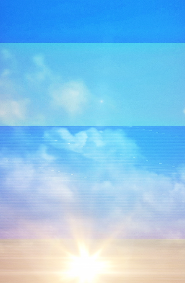

I have a major issue with dvx3 importer inside of after effects 2019. The codec seems to import all other media clips, mp4 or prores by default as dvx3coreimport and is unable to properly read/ write these files. As a quick fix, I have stepped back to AE 2018 and the problem is gone. This seems to be a major bug that should be brought to the attention of the developers. This bug in effect renders my AE 2019 completely unusable since I am unable to to locate the codecs and properly uninstall them. For now I am sticking to AE 2018 until there is a fix.
Screen Shot 2019-10-30 at 4.40.29 PM.png (316.15 KiB) Viewed 12429 times
