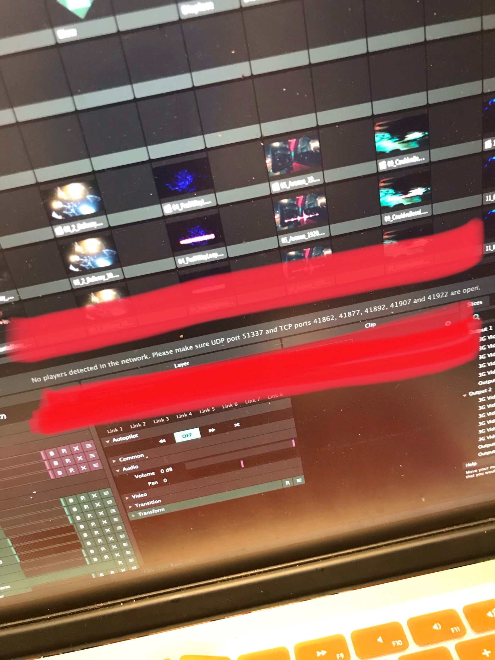

Hello Everyone,
I’m having an issue finding the two timecode clocks that should show the in coming timecode signal. I know where they should be, but they are not visible. I’ve attached a photo showing what’s located in that spot. Any and all assistance will be greatly appreciated!

Re: Looking for Timecode Meters
Try disabling Show Denon Stagelinq in the View menu, and make sure you have a SMPTE input selected in the Audio preferences.

Post by LightGuyCalvin »
Thank You Zoltan! Turning off “Show Denon StageLinQ” allowed the timecode clocks to show. I had the sound input and output setup properly.
Cheers!!
