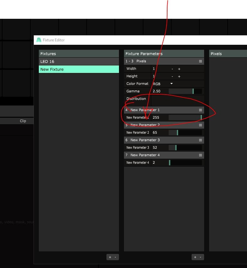

Have you a timeline on when you will be making the Parameters in the New Fixture tab available to be animated like it says in the hover over help.
If these Parameters where able to be animated, I could use them to run Moving heads and other lights.
Currently I am trying to use Freestyler for this, but would much prefer one piece of Software.

a fixture is just a fixture.... it is just a static information sheet on how many channels your lamp use and what channel do what....
animation you can get via the comands on this channels... so a white image will give you 255 on the channel and black will give you 0.
The artnet/dmx output of arena is mostly for non moving led fixtures ( so just the color & brightness) and that work very easy.
When you want to have some movinghead movements inside arena you will need to work with (at least) 2 workarounds :ugeek:

Working with moving heads is exactly what I want to do. But How in Resolume???

you ll need to build some dummy clips to get the right values wich are then translated into dmx...
Grab the color from your vj clips and the rest from a dummy layer
so i.e. when you have a solid color (white) and fade this clip from 0 -100% you can get the dmx values from 0 - 255 when you now send this values to the pan channel of your moving head then the moving head will pan from 0 - 100 (position)
Ofc you can have multiple solid colors in one clip and controlle many fixtures / channels inside one clip.
you may see now that resolume is not a software for moving fixtures but with some work it can work and then you spare the extra software....
