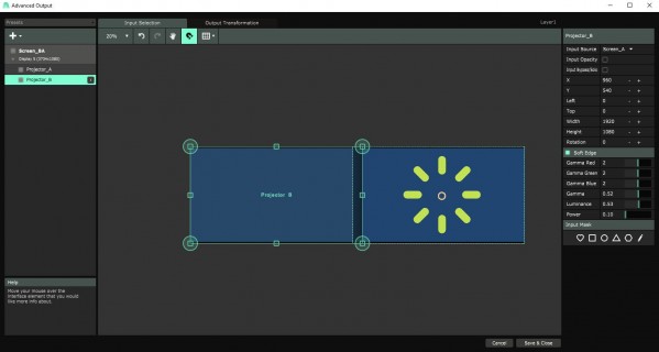

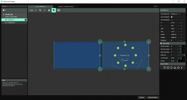

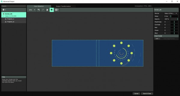

I'm new to resolume, but yes... I've watched the edge blending tutorial and read the page thoroughly. To the best of my knowledge I have setup my advanced output properly. I am having an issue with edge blending on a 2 projector setup that has a physical overlap of a few hundred pixels. It appears as though only Projector 1 is outputting the blending, you can adjust the gamma/brightness etc. on it's relative slice as well. Projector 2 is not outputting any blending, and it's slice is has all the adjustment options, and also has the soft edge box checked. The adjustment options on projector 2 appear to do nothing. The result is that one projector overlaps the other with the proper blending. When I disable the output for projector 1, it reveals only projector 2 with a bright strip where the overlap should be.

How does your Output Transformation look like?
Can you post a picture of how the built in test card looks like on your outputs?
(you can find it in the output menu)
What happens when you right click on the Projector A Gamma slider?
Also, the slice settings for Input opacity are different
