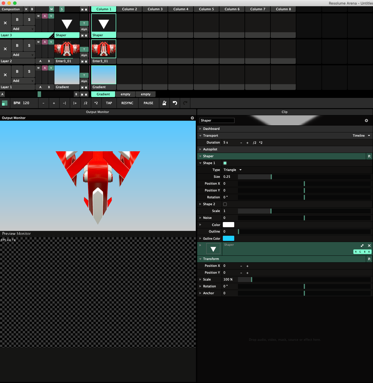

What you can do is create a Third layer that is a Mask for the Second Layer.
So create a Third Layer and set it to Mask Mode -> One Below
Any content played in Third Layer will act as a Mask for the Second Layer.
For the Triangle, Load the Shaper source in one of the clips in the Third Layer. Chose Triangle for Shape 1, set the Outline to 0.

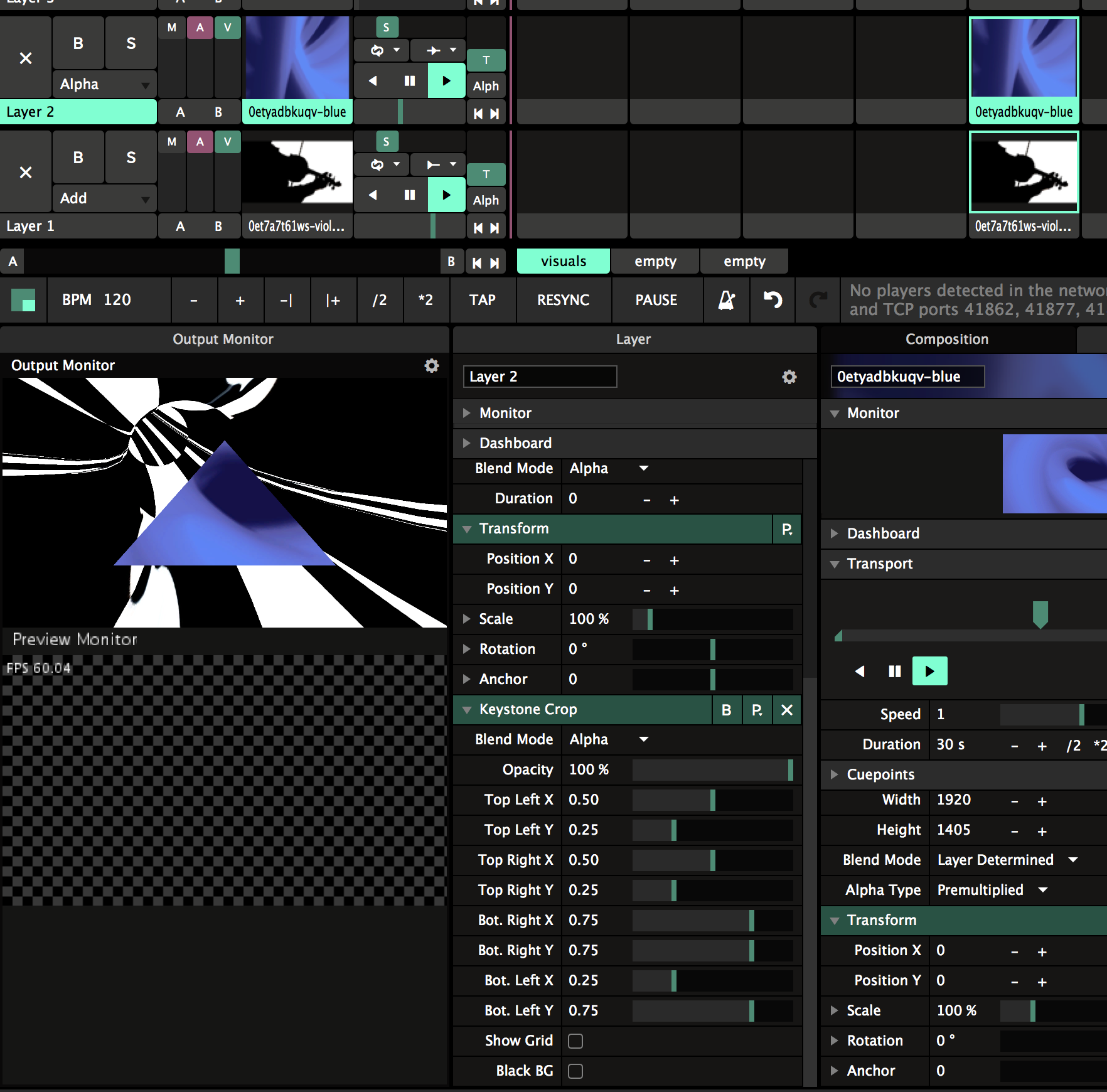

Or put a Keystone Crop Effect to the layer you want to show as a triangle, and set the Top left and right X to 0.5
