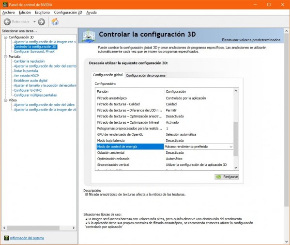

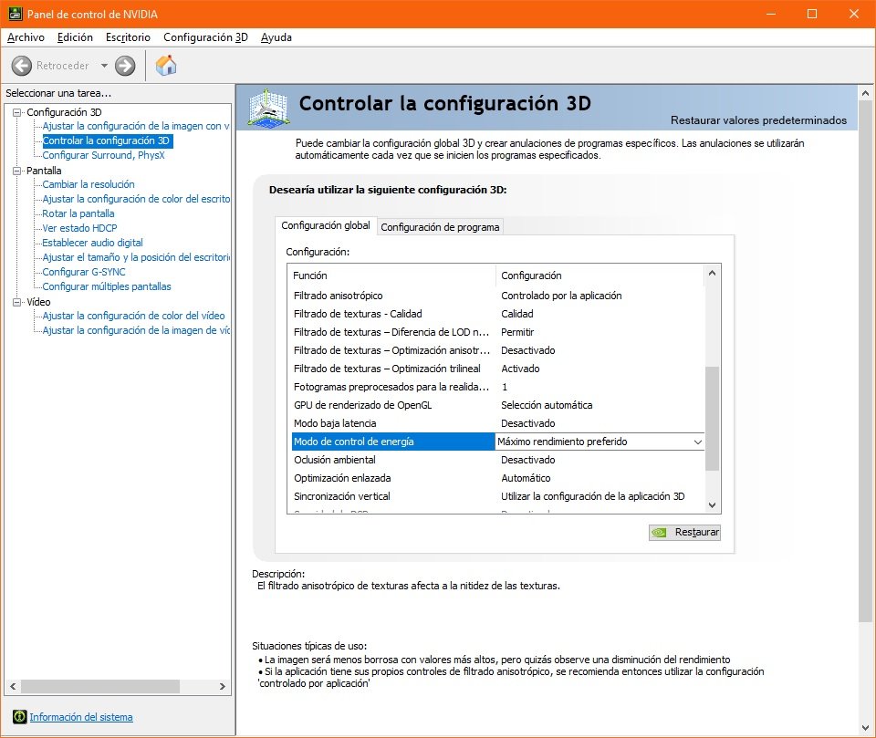

Is nvidia 3d settings set to maximum performance?

Zoltán wrote: Tue Jan 07, 2020 15:33 Is nvidia 3d settings set to maximum performance?
Good afternoon.
In the global options I have this box checked:
"Power control mode: Maximum preferred performance"
And for the program Resolume also the same.
Is there any other option that I should configure?
