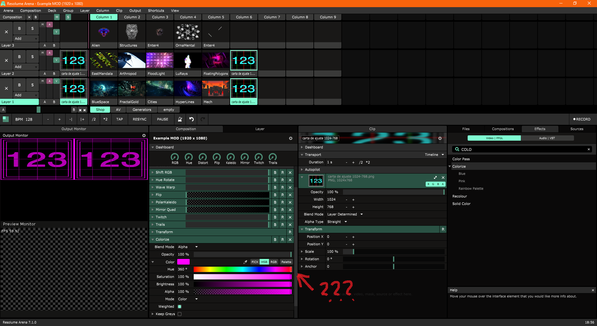

The other fault that I have found in addition to the previous ones, is that the Colorize effect when you take the "HUE 360º" marker to the right until the end, you get the color pink... :?
In R6 if you did this, the color was red.
Does it happen to you too? :?:

visionjenoma wrote: Sun Jan 05, 2020 20:37 Colorize effect when you take the "HUE 360º" marker to the right until the end, you get the color pink...
Ticket #13548, can be worked around by adding an envelope to the Hue param, and moving the envelope end point to 359º.

Yes, with the value 359º I get a red color, but I am not convinced by the solution... :roll:
Posts: 7590
Re: Colorize effect failure in Resolume Arena 7
visionjenoma wrote: Tue Jan 07, 2020 16:57 Yes, with the value 359º I get a red color, but I am not convinced by the solution... :roll:
It's a workaround ;)
We're working on a fix.
