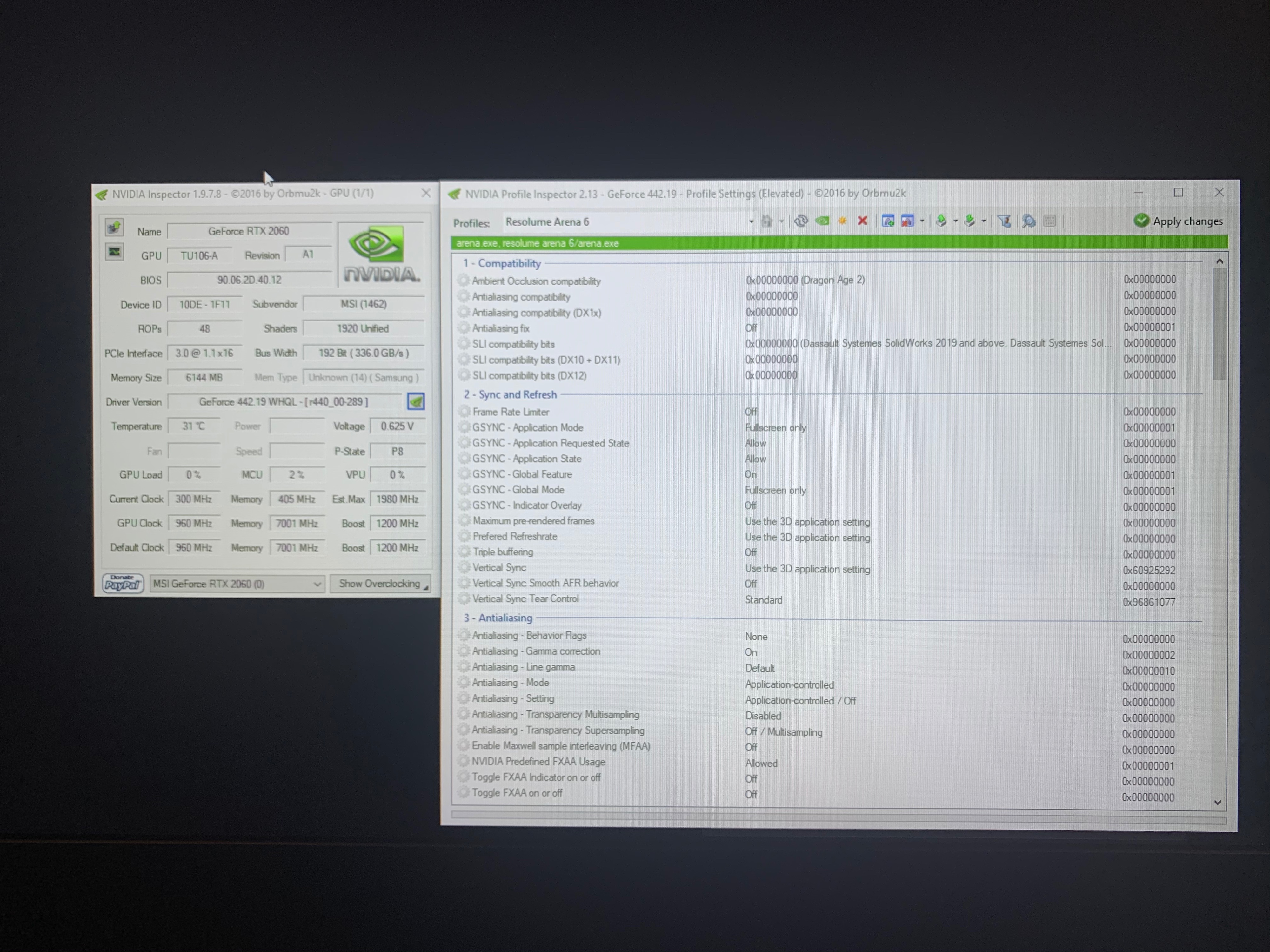

When I add my executable the preset order is incorrect. I would love any help fixing this. Sorry in advance I’m still learning. My FPS will drop to single digits when triggering a column or single clip as well (seems to be random). All clips are full HD and the most I trigger is 5. I’ve read everything the forums have to offer on optimus, vsync, and composition frame rate etc. and believe my settings are all correct. I still can’t figure out what’s causing this so hopefully the workaround solves all my problems.
MSI GS65 Stealth 9SE-478
i7-9750h
Nividia RTX2060
32GB Ram
Posts: 7600
Re: Msi Stuttering issue
Nvidia has a built in preset for Arena 6, and Resolume 7.0.5+ installs the preset for itself.
Try to do a clean driver install, and get the latest Resolume 7 installer from our download page.
Then when it asks to give Admin privileges, allow that, and you should be all good.
The preset is installed with the default app path, so don't move the executable from c:/Program Files/Resolume Arena.
