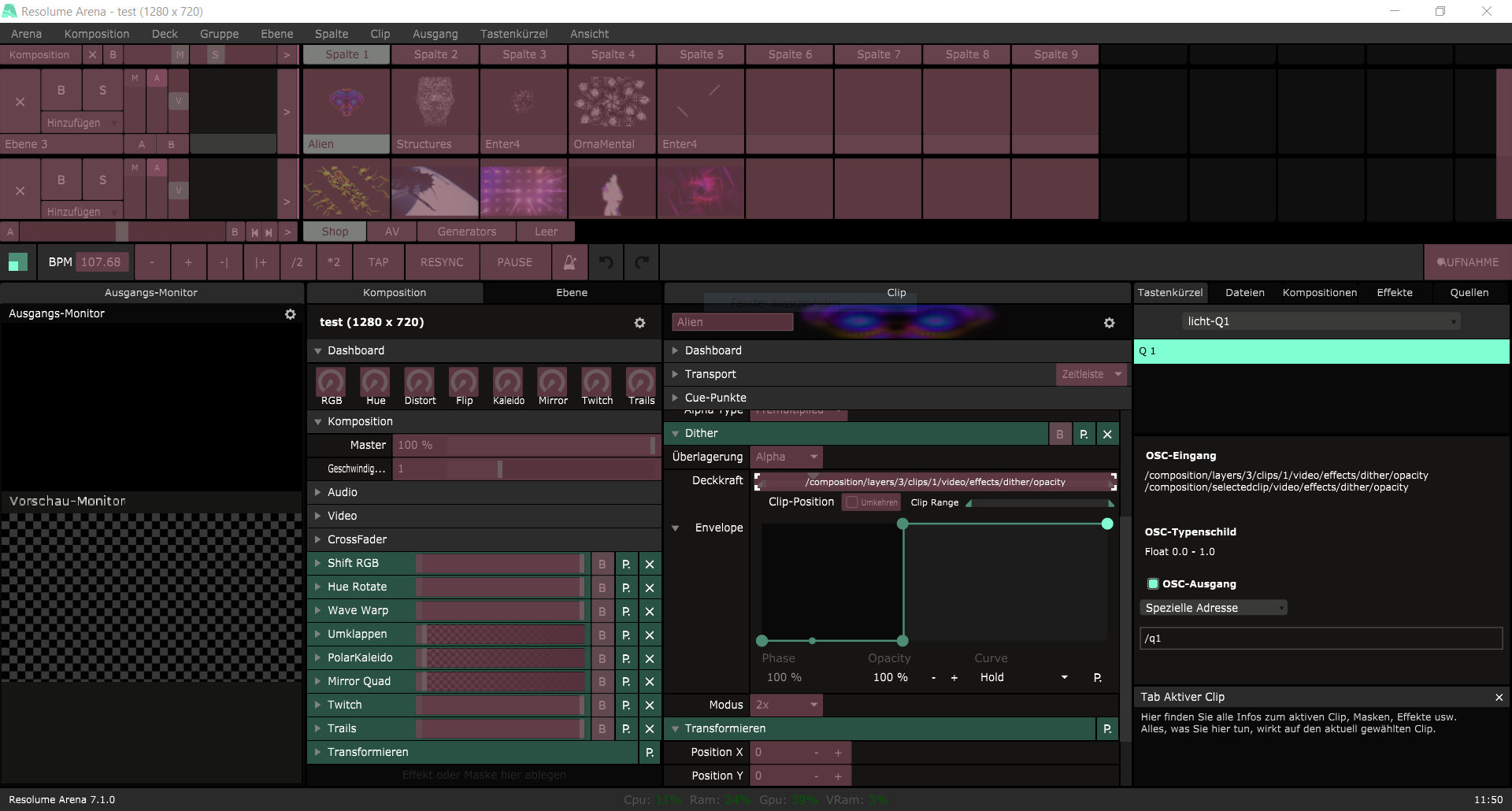

the Envelope is not possible to take as OSC output. i tuk the slider of Opacity which folows the Clip position.
this gives me again thousends of OSC signals.
so i reduced the Clip Range to a single point. this seams to work. the position of the Clip range point defines the signal output. the precisition is with 0.01 maibe not enough for very long clips.
if the Clip is 20min long so 1% is 12s.
is this the way you mend it?
Re: Sending OSC at a specific Clip position
The Envelope is just an extra to the opacity and has no osc on its own ...
Mhm...
Not sure why the fader still give you so much osc info when the envelope is set correct ( i dont see a misstake on the picture)
Mhm...
OSC output for parameters, is the actual parameter phase.
When you enable an envelope you still only get the phase, not the actual value.
What you could do, would be listening for the float 1 value (if your software can ignore floats below that)
and set your parameter to timeline, play once and hold.
Then you can set the Duration which will specify the amount of time your param needs to get to 1f.
If this doesn't work, try controlling your Arena instance from your lighting software via DMX: https://resolume.com/support/en/dmx-shortcuts
or use a bridge app that will fire a specific OSC message to your DMX software based on incoming OSC data.
