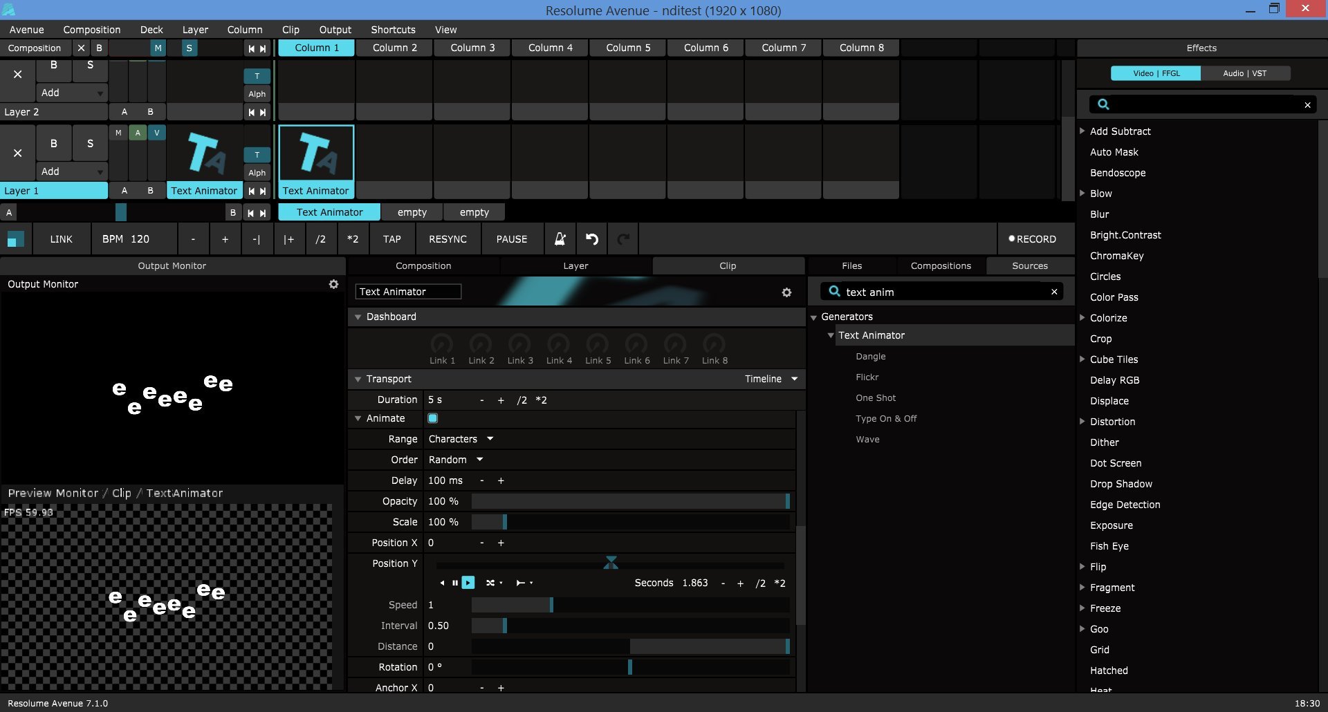

I think this may be related. We've being sending a composition with alpha through NDI from a laptop running Resolume Avenue 7.1 to another one running the same version. The footage received had many black artifacts.
We tried sending different footage with alpha (DXV footage, Spout ) to see if the problem was with the source, but the problem remained. We also tried sending only a layer through NDI with advanced output and still no improvements.
I'm posting sample footage in which we sere sending some white moving text with alpha from Resolume's Text Animator . The red background was added later in the receiver to be able to see the artifacts, since they are black

Actually it's not footage... It's just a Text Animator generator from Resolume (See attached picture). We are sending this through NDI to another computer and the glitches appear at the other end.
However the same issue happened as well when sending other sources, such as DXV3 footage with alpha. At first we thought it might be a problem with the encoding of the footage, that's why we used a generator.
But the problem persists with generative sources that have transparency.
Cheers
