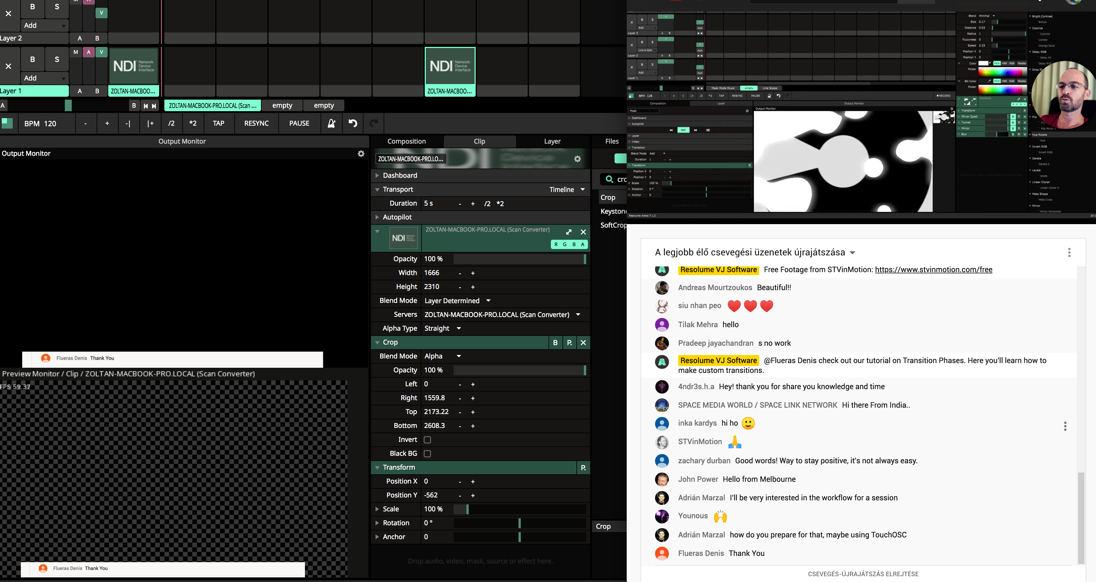

How about let NDI Scan converter grab the youtube window, and bring that into a clip from the sources, and crop it?

Zoltán wrote: Fri May 08, 2020 11:25 How about let NDI Scan converter grab the youtube window, and bring that into a clip from the sources, and crop it?
Hi there! Thanks for your input! That would be the perfect option to include the whole chat window, for example, the thing is I'm looking to isolate specific comments, in this case, the superChat ones. My idea is to give people the option to pay (with the superchat) to have their message displayed on the main screen, so I would have to choose just he comments to appear, and also, if I go with the NDI Scan converter grabbing the YT window and crop into just the individual comments, then there's the problem the comments keep going up and therefore going out of my crop. Ideally, the whole process would be automated, I think I found a way with (IFTTT) to have the Superchat comments be sent to a google sheet.

The text of the Text Block can be changed via OSC, maybe you can build a bridge app that takes the text from the chat and sends it via OSC instead of a google sheet.
