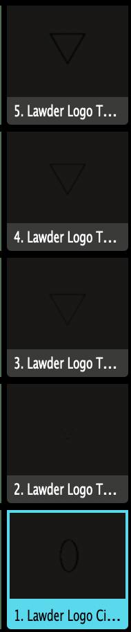

I am fairly new to Resolume Avenue 7 and I am currently optimizing my workflow.
An issue comes up in working with small transparent images that are black and relatively small.
In the thumbnail of the clip, the transparent background shows the color of Resolume's background and it's hard to distinsguish the black content from this color.
Anyone have a solution for this?
Thanks in advance,
L.

You can manually create a thumbnail then update it.
In Resolume -> Right Click the clip -> Thumbnail -> Load from file.
I'm lazy so I might do it all in Resolume. Throw a colored background on the clip. Right Click the clip -> Thumbnail -> Update. Then remove the background and call it a day.

i guess you can update thumbnail for multiple clips at once ;) but still the background have to be added for each...
