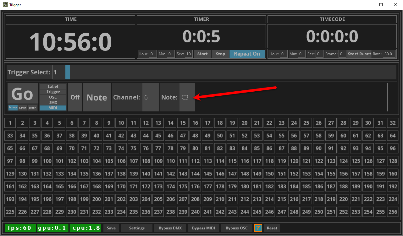

BTW, I just updated the Gumroad Trigger files to also include a "Beta" in your Documents Trigger folder. This version has MIDI built in to keep down on the middleware. I haven't tested it but it should work "in theory... lol" MIDI in TD takes a bit of work to setup but I hope I did most of the heavy lifting to get it working.

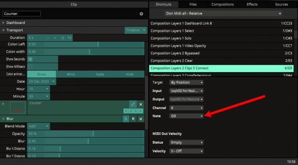

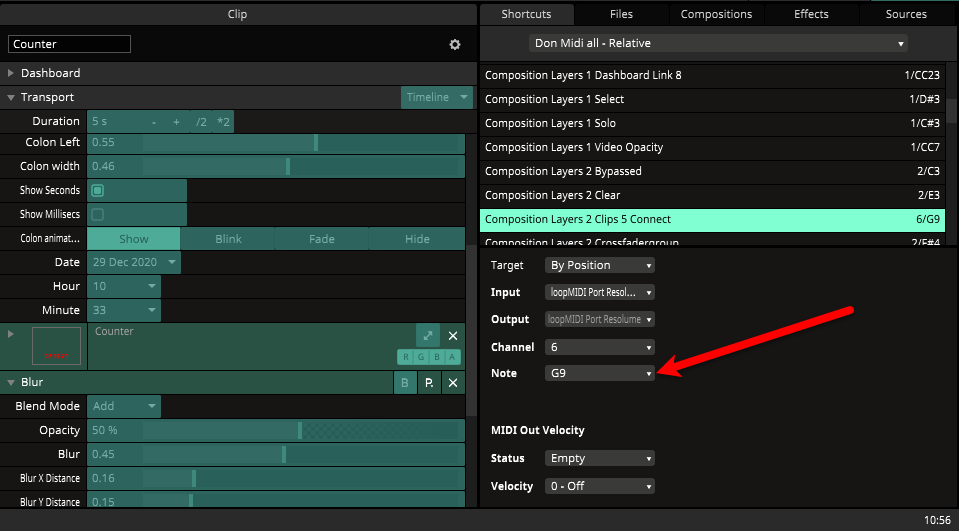

I may not fully understand setting the Midi note in your app vs what Resolume receives. But just in case I found a bug, I set a "C3" note in Trigger, and when I triggered it for the Resolume midi map, Resolume said it was G9.

TD is a lot different than normal apps. "Like I said, it's a pain". I try to strictly use OSC with a few DMX implementations when I can.
They way TD structures MIDI is "ch" for the MIDI channel, followed by the channel number, followed by "n" for note or "c" for cc, followed by the note or cc number, so to get it working it will need to look like:
ch0n22 for a note, or ch0c22 for a cc on channel 0. Unfortunately TD doesn't use the normal C#3 formatting system. (Or if it does, I'm an idiot and have been using it all wrong these years lol)
I did all the formatting for you, you just need to find out what note or cc number your controller is sending out. You can use the MIDI input to press a button or turn a dial to see what TD see's that devices note or cc as. OR if this is just internal routing, set a note or cc and then press the "GO" button on the app and use Resolume's MIDI input monitor to see what it registers as and then map that note or cc to your Resolume's comp.
Again, a pain in the butt lol, which is why I try to avoid MIDI in TD at all costs. Would OSC not work?

Also be sure to use the MIDI setup button to setup your MIDI devices in and out in the Trigger app

Got it, thank you! I have a Midi to Note number chart. My only observation is it looks to be shifted by 1.
Note# 19 should be "G0"
Reolume registers #19 as F#0 (which should be #18)
Note# 20 in Trigger, reads "G0" in Resolume
Hardly an issue and this is highly useable. Thank you for the hard work on it and the explanations!
