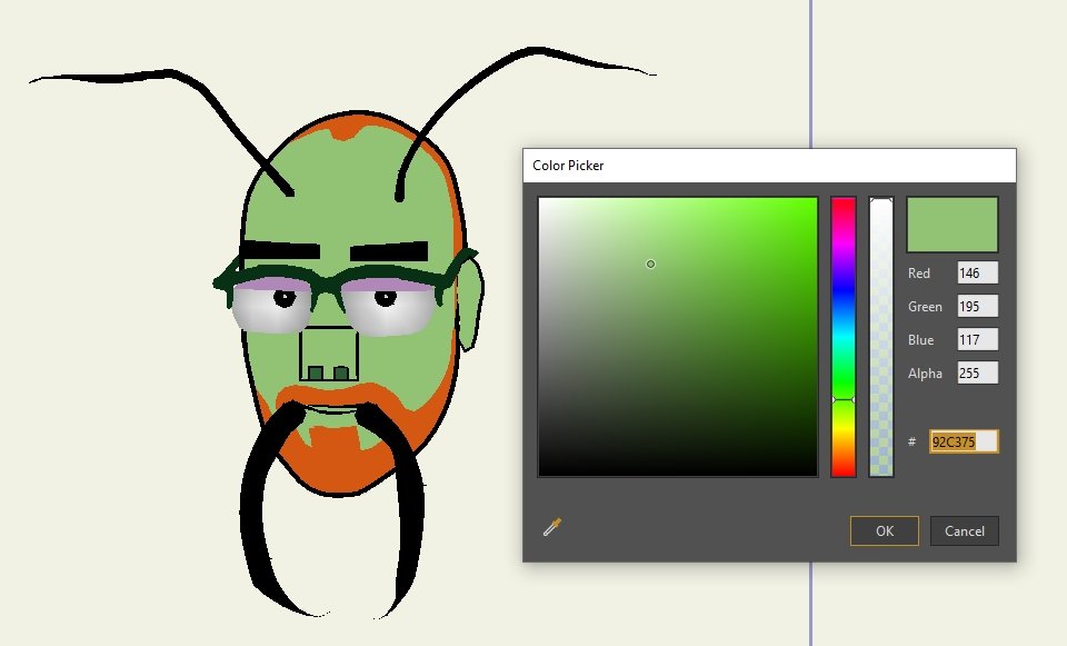

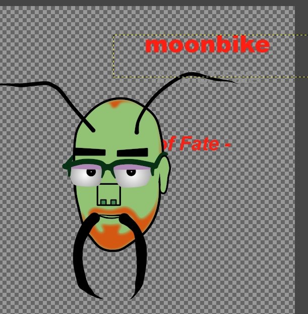

I created some pictures in Moho which should be opaque, alpha is 255.
When i look at the pictures with Gimp, I cannot see through them.

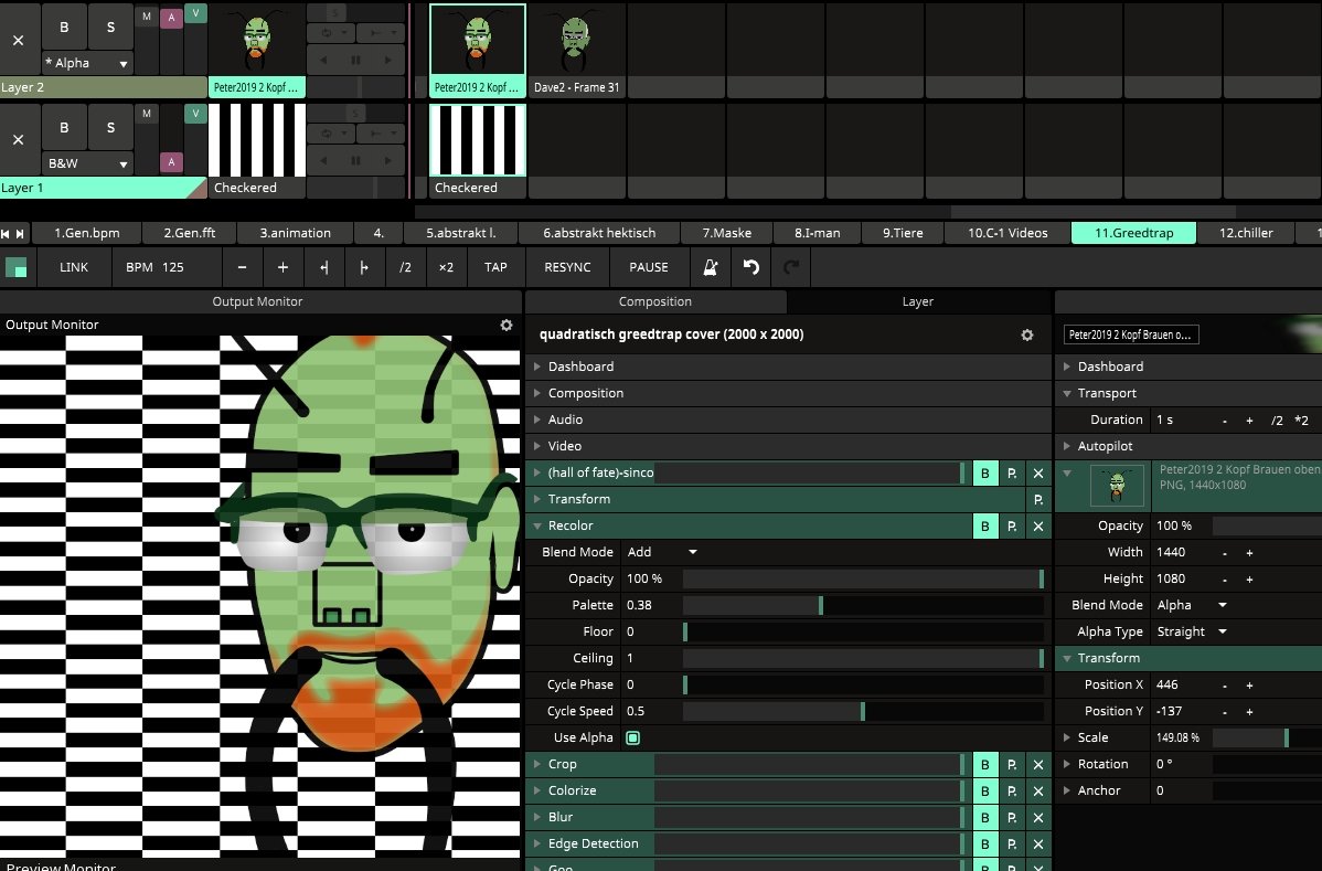

But in Resolume the .png pictures are transparent, although I use the "add" or "alpha" blend mode. For example I can see a checkerboard source behind them. How can I tell Resolume to treat these pictures as opaque?

I created a new composition with the .png picture, and the head is opaque, like it should.
Then I removed all effects and everything in the original composition, but the head is still transparent.

Works Fine for me. It might be a layer blending mode, or maybe your master or video fader isn't turned all the way up?
https://drive.google.com/open?id=1o1230 ... p=drive_fs
***Confirmed***
You're layer 2 master isn't 100%
***Confirmed***

Damn! I never use the master fader
Thanks a lot Arvol for your help. It's sometimes very difficult to find the fault when you caused it yourself.
