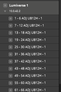

JGP
Posts: 4
Joined: Sat Jan 15, 2022 12:59
Re: Dmx Fixtures with RGBAW+UV
Post by JGP »
To bring this back to the devs attention.
I have a very messy setup, because each pixel has to be mapped individually, instead of a pixel-strip.
Please allow to add the ability to add a spacer channel to each pixel
RGBAW UV singel pixel mapping.png (8.92 KiB) Viewed 17745 times
