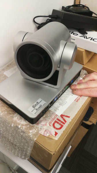

Hi folks.
Feed is coming through NDI. Looks great.

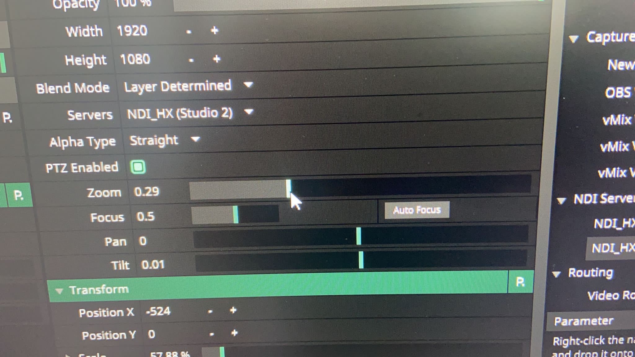

Ptz controls isn’t working through resolume even tho activated.
Controls DO work through ndi video monitor
Any advice?

Sounds like the cameras you try do not support Absolute positioning, which is defined in the NDI standard. Manufacturers often skip this for some reason, so they are not 100% compatible with NDI.
I'd recommend contacting the manufacturers.

My PTZoptics NDI PTZ works just fine in Resolume. It's the manufacture, Not Resolume.

Maybe this would be good GitHub project:
Resolume PTZ Control Compatibility Module
Receives absolute commands and translates them to relative commands for non-Marshall, non-PTZ Optics cameras.
