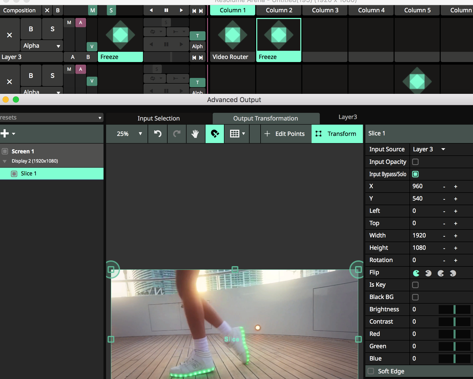

Freeze effect on the top layer, opacity turned down, routed to a slice, slice input opacity checkbox disabled, should work. https://resolume.com/support/en/slice-routing
You'd also need a simple video router to switch back and forth.
