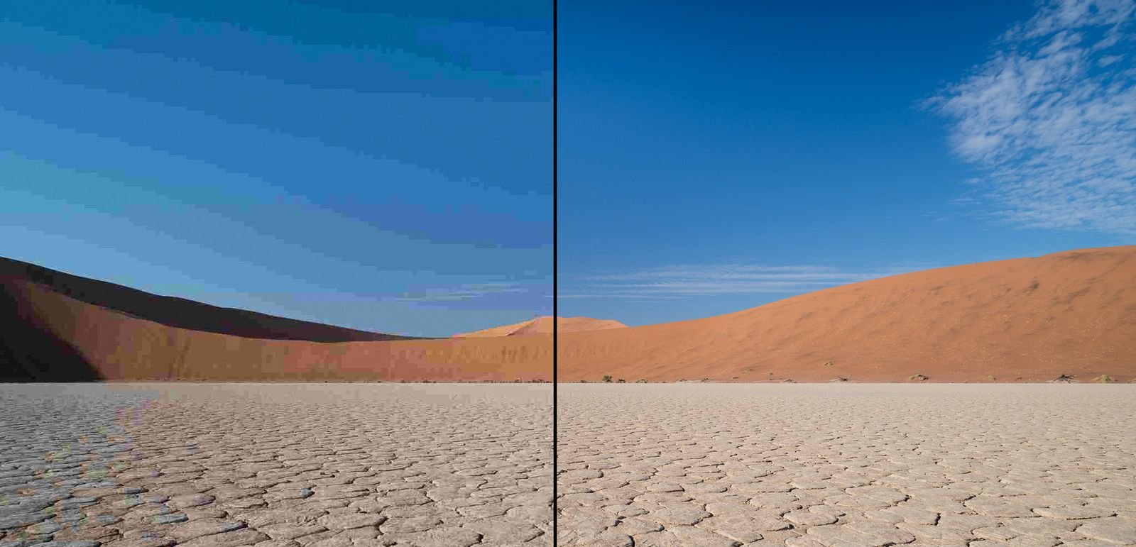

The short of it: Does encoding to DXV cause color fringing/video moires in content? See the attached photo for an example of what I mean. It's an exaggerated example, but we have all seen those "ridges" pop up in certain types of content, usually when viewing the sky.
The long of it: I recently had 1080p content delivered to me for a film shoot and, upon playback on the LED wall, similar "ridges" (or video moires, whatever you want to call them) showed up in the sky portion of the content and it sparked a big discussion: The content creation team of course wanted to blame the DXV codec for this and, while I'm skeptical that that's true, I wanted to ask about it here.
What causes this? I know it has to do with compressing the video, but is it endemic with the DXV codec? Is there a way to avoid this in the future?

I work in filmmaking, but am not an LED wall expert. Arvol is and will chime in.
A couple of thoughts:
(1) I am of the opinion that even the 10-bit version of HAP isn't good enough for this.
(2) 8-bit DXV is definitely not good enough for this.
(3) It's not just the file format. It's the software, hardware, cables, video processor, and LED tiles.
Bottom line:
Eliminating banding is quite expensive. And, they likely will have sticker shock.
EDIT:
Question... how did you create the banding example? I like that effect. Is that from ShaderToy?

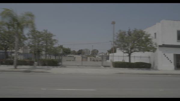

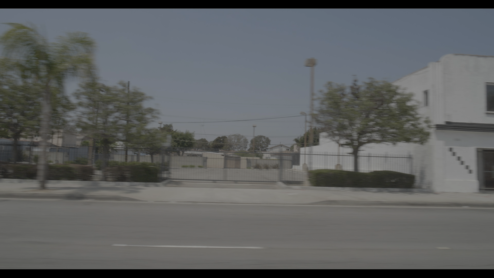

So, got your file from Arvol, indeed really hard to say where things went wrong with the colors. The video is also looking quite underexposed. Is it supposed to be HDR? Looks a lot like the shot on the right here http://resolume.com/forum/viewtopic.php?p=85381#p85381
Can you upload the original file your team converted to DXV?
