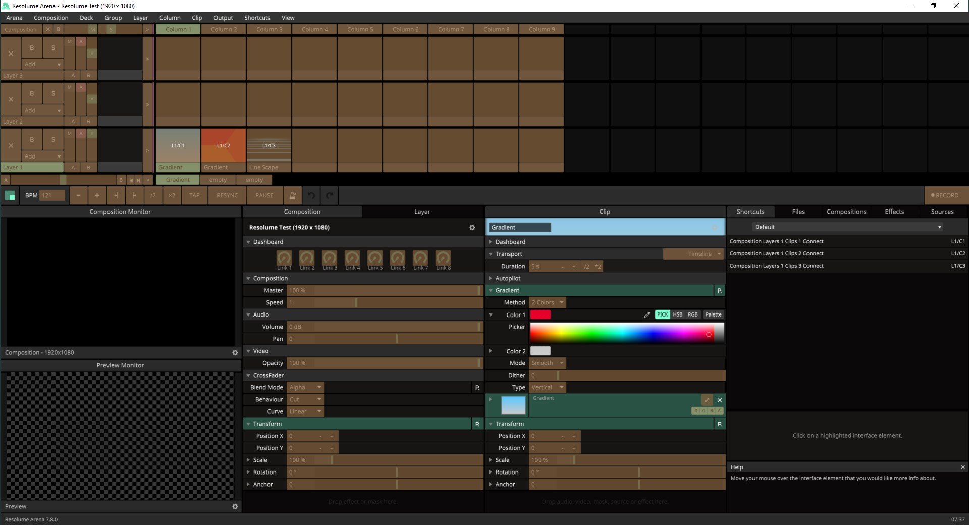

I have set up three channels to trigger 3 clips as a test at this stage. Channels are 1 to 3 on DMX 1 to 3 and all on DMX Universe 1.

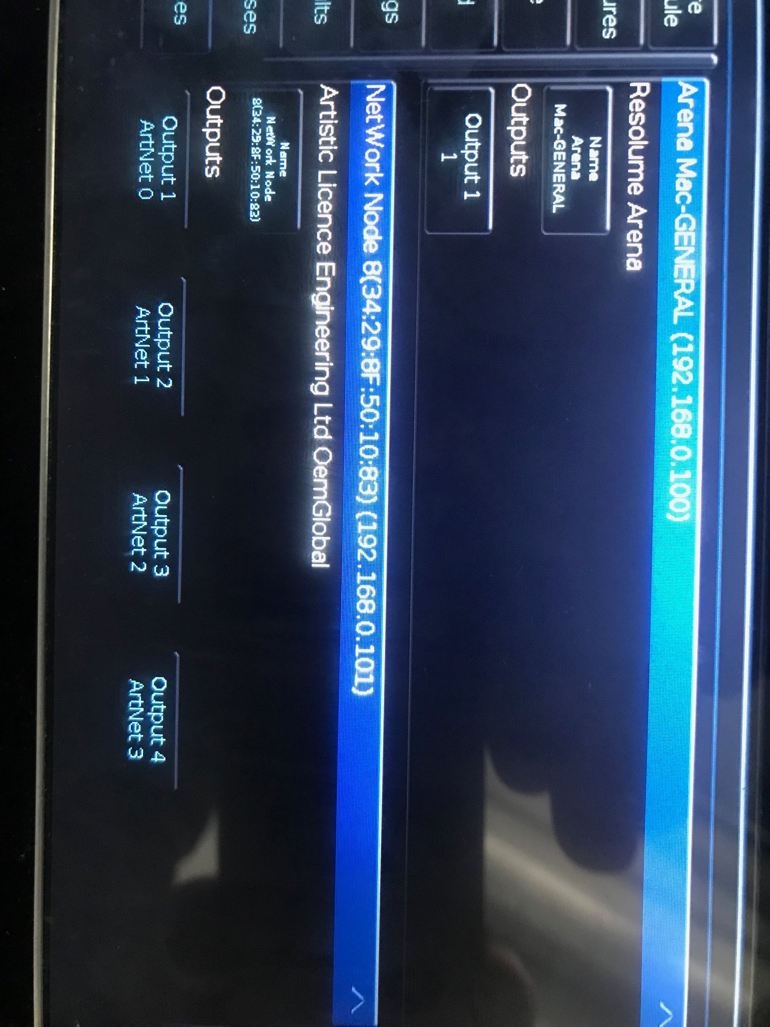

DESK - Please see (FLX Desk View) image. This to me indicates the desk is seeing Resolume on my PC but it did not trigger the clips when I activated each channel to 255. The DMX preference for network adapter was set to ethernet.

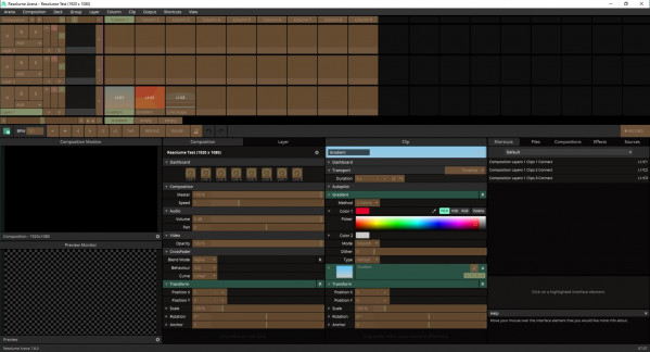

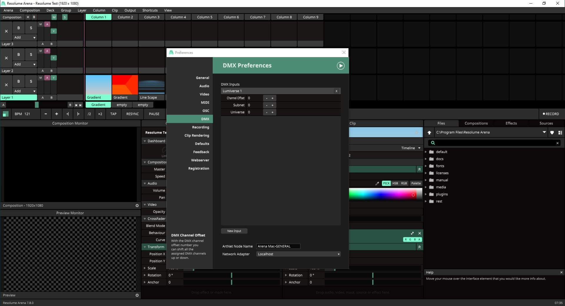

PC - I have set Resolume as per the attachments (PC -DMX Preferences, PC - DMX Shortcuts).

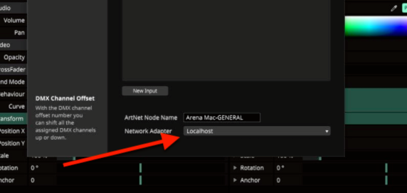

This should be set to your ethernet interface: https://resolume.com/support/en/dmx-sho ... rk-adapter

I am trying to run and set up Resolume on both my lighting desk and from the PC. So trying to set up both as I will use the lighting desk for the live shows but the PC with the lighting software and Resolume on it for programming. So never together and I understand when using the physical desk to choose the ethernet network adapter and when using the PC to use localhost.

There is that small play button in the top right corner in the Resolume preferences. Click that, and it will open up the DMX inspector.
There you'll be able to see the channel activity. If your DMX software sees the Resolume node, it could be a simple universe numbering issue.

OK, got back home and tried Resolume and the lighting software on the same PC and they are still not talking to each other. It is a Win10 PC.
I changed the Resolume network adapter to 'Localhost' for this.
Is there anything else I need to change please. As I am now confident I have set up my DMX shortcuts correctly as I have triggered them from my desk.
