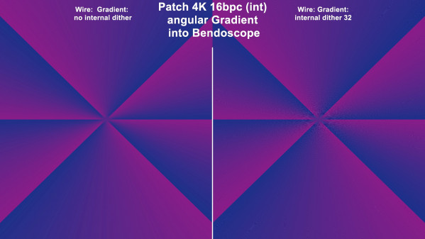

The dither is not a cure-all; you can get some strange artefacts if, for example, you use high dither in Gradient with Type 'angular' into Bendoscope, as shown here: https://vimeo.com/675254871/0d5b49a1da

And just to show that Dither in Gradient is not a silver bullet, here's an image from this side-by-side video (https://vimeo.com/675254871/0d5b49a1da) showing dither=32 on angular Gradient into Bendoscope in a 16 bpc patch exported as ProRes422. Note the artefact on the right in the centre:
