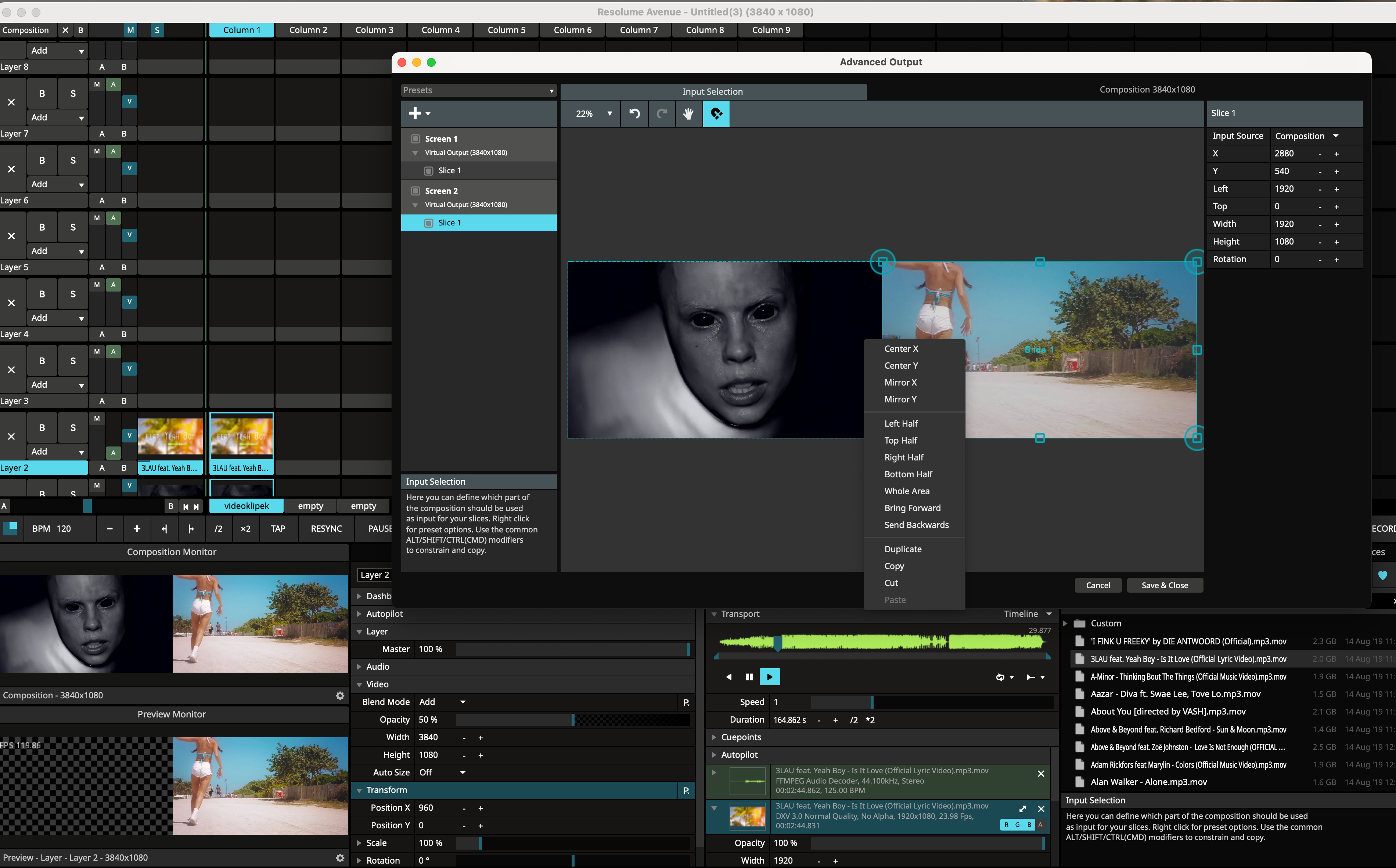

You can create multiple screens in the advanced output for sending to external displays in Avenue. https://resolume.com/support/en/advanced-output
For example, if you have a double wide 1080p composition, you can make the left half of the composition go out to display 1 by adjusting your input slice in screen1 to take the left side of the composition.
Then similarly adjust the screen2 slice to take the right side. That will work fine for two 1080p outputs.

OK so it looks like this could be my solution, as I only need to get an SD signal out to my 4 outputs
Thanks! I will let you know how I get on
