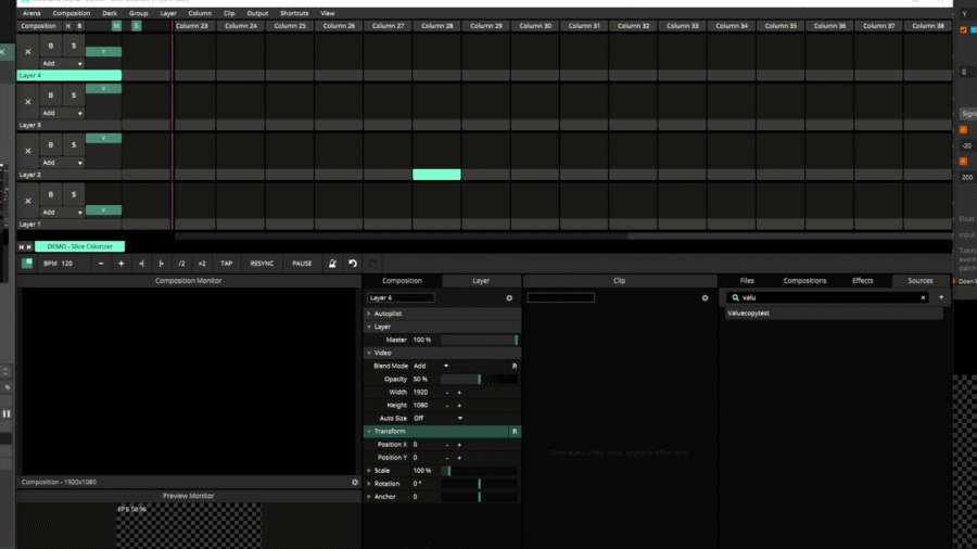

Hey there,
may found a little hickup. Copying a wire patch inside the clipdeck does not carry all information with it. Maybe because they are negative?
EDIT: It seems not because the value is negative...the reason seams to be because I use two Float In nodes with the exact same name "Y"... When I rename one to for example "Y_" the value is copied correct.
Wire & Resolume 7.11.3

Re: Wire - Some values do not copy inside of Resolume
I think it's because the parameters are named the same.
With those Resolume can get confused a bit.
Rename the params so they have unique names ;)
