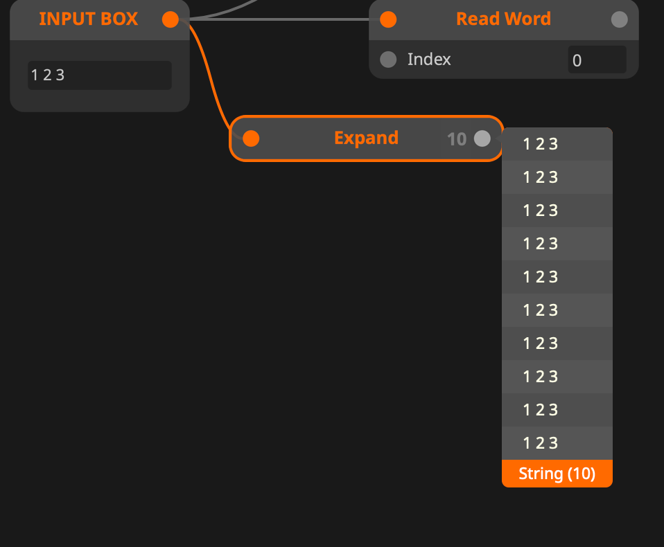

Expand can make multiple instances of the input

Thank you zoltan but it wasn't what I wanted to do.
I will try to explain clearer:
I would like enter some numbers on the 'string' node (lets say I wrote 3 numbers)
Then I want the 'count word' node to count the number of words (3)
And now for the problematic part I want to take the 'count word' output (3) and create a node which will give me 3 instances (0, 1, 2) which I would like to connect later to some index node.
I achieved this using linear, but the linear won't allow me to dynamically change the instances size.
Here is what I meant:

Dynamic instancing is not available currently for nodes in general.
There is a Read Word node you could use to get the specific word. If you supply an instanced index for it, then it will return an instanced output of the words.
