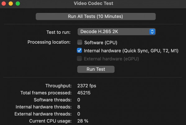

Just curious.. if you run the Ben Software Video Codec Test https://www.bensoftware.com/videocodectest/on your 2019 MacBook Pro, what are the results of the Decode H.265 2K test? As a frame-of-reference, my 2021 M1 Pro MacBook Pro can decode 2372 fps when the internal hardware encoder box is checked.

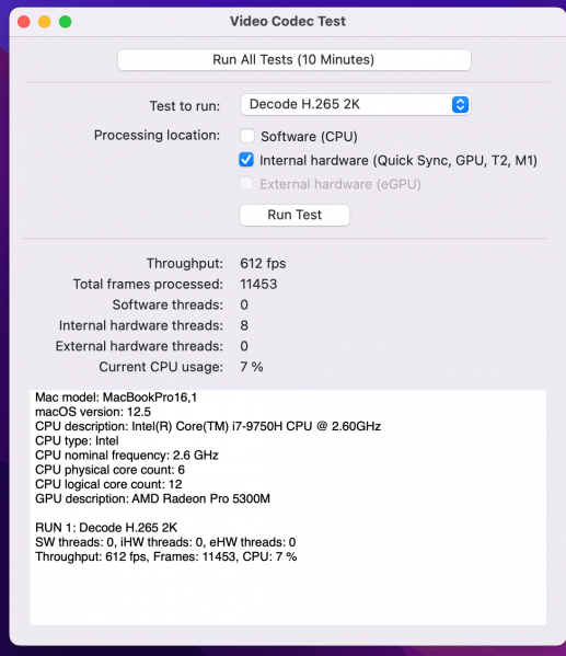

HI: Thank you for helping! Here's what you asked for, please explain the situation looking it through the results.

Thanks for sharing! I really asked for my own curiosity, because I found out about that Video Codec Test app after I sold my Intel MacBook a while ago. So, looks like, at ~600fps, you should be safely good for up to (10) 1080p60 .MP4’s. So, if you’re experiencing performance issues, you know it’s not related to the mp4 decoding capacity, so long as you’re below the threshold of ~600fps aggregate across all the video clips.placido wrote: Sun Aug 14, 2022 15:55 HI: Thank you for helping! Here's what you asked for, please explain the situation looking it through the results.
Zoltan’s suggestion sounded wise: revert back to macOS Big Sur, if you can. Might be tricky, though.
