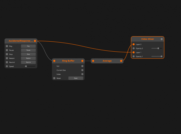

MarkyMark
Posts: 120
Location: Groningen
Re: Wire Variable Step Delay with Composite Mode
Post by MarkyMark »
There are many ways to do that.
You could use the Split node to split the collection of frames up into indiviual channels and mix them how you see fit.
My personal approch would be Ringbuffer -> Average -> Video Mixer (mixing it with the original signal).
You could also use Sequence -> Read + Ringbuffer > Read to read frames every X-frames (a delay with intervals).
There is also the Merge node which has alpha blend and add as modes.
