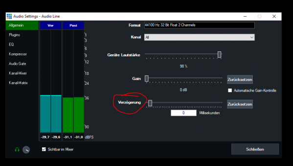

Posts: 1627
Re: How to stream a DJ+a VJ
Audio is normally faster than a Video-feed....so...just delay your audiofeed in vMix

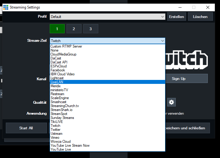

One way to preview and check if your delays fits is to use the LiveLAN Streaming option in vmix
Best wishes
Chumbaz
Joined: Tue Mar 17, 2020 11:01
Post by Chumbaz »
cosmowe wrote: Wed Dec 28, 2022 12:38 Audio is normally faster than a Video-feed....so...just delay your audiofeed in vMix
Best wishes
i was aware how to delay in vMix, but was not thinking to the LiveLAN trick... thank you
