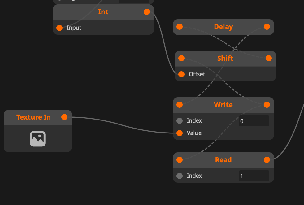

I'm using a ring buffer for a video effect in wire.
Since the buffer uses a lot of memory, I was wondering if I could make cover more time by skip texture frames (effectively forcing part of the effect to run at a lower fps). I've tried some variations of using another buffer & a 'read' node to reduce the frame-rate, but that does not seem to effect how fast the downstream buffer fills up. Even if texture buffers are not connected to anything, I can can still see them filling up at 60fps.
Is there a method for throttling texture signal flow?
Thanks.
Posts: 7651
Re: Texture fps control in wire?
You'd need to make your own buffer, where you can shift the buffer manually.
Set the instance count in Delay, to set the buffer size.

Thank you!
I'll need to muck around with this before I fully understand, but this seems like the right track.

I did get this to work, so thanks again.
A related followup question...
Is there a way to make a control for the number of instances on a node (effectively changing buffer size)?
I tried setting up different buffers to switch between, but it seems like the GPU just processes them all regardless.
