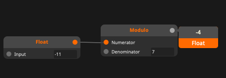

It looks like the Wire node 'Modulo' gives incorrect values for negative numerator inputs.

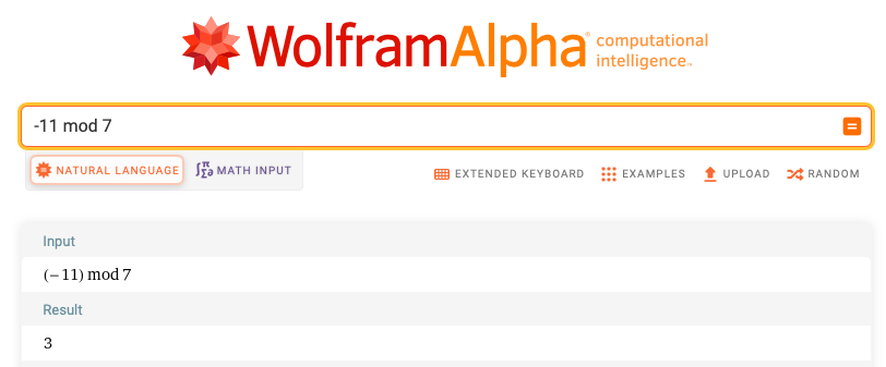

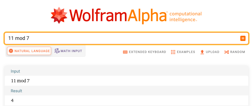

Example according to Wolfram Alpha:
11 mod 7 = 4
-11 mod 7 = 3
In Wire:
11 mod 7 = 4 (correct)
-11 mod 7 = -4 (incorrect)

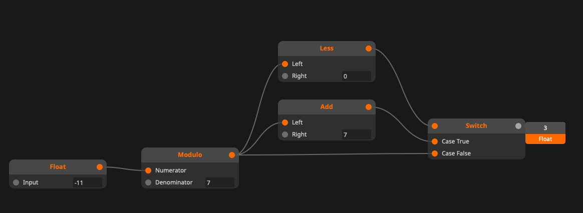

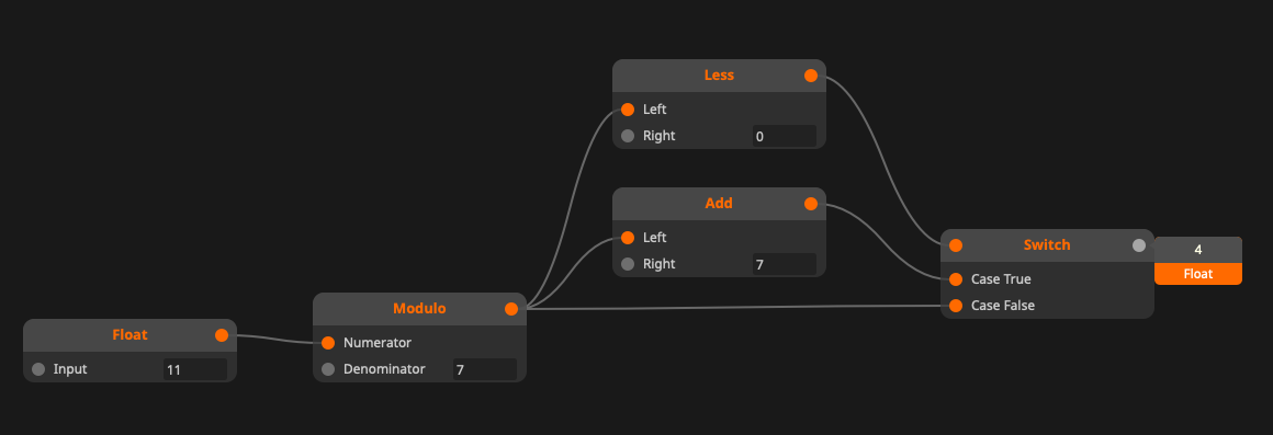

The correct Modulo result for negative inputs can be achieved in Wire using a few extra logic nodes:
If the Modulo Result is less than 0 then add the denominator to the result.
-11 mod 7 = 3 (correct)
