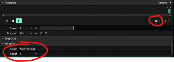

I am trying to build a very simple resolume project where a clip is triggered and then I use an auto follow action to play another clip which then loops infinitely. Lets call these clip 1 and clip 2.
Initially this worked fine, however I made a change to the retriggering behaviour because I did not want the clip 1 to start again if it was triggered again before it had finished playing. I changed the play behaviour to "continue" rather than "restart" in transport controls.
At this point Clip 2 does play after clip 1, however when I retrigger clip 1 (which is 15 seconds long) it has stopped playing at 14:24, rather than the end of the clip and does not retrigger.

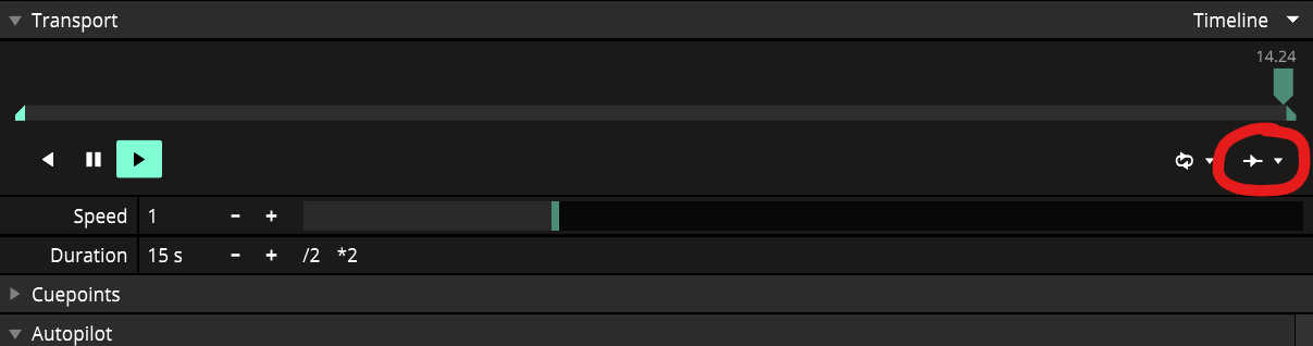

Solution 1 : have the clip set to loop and then in autopilot set the number of loops to 1.

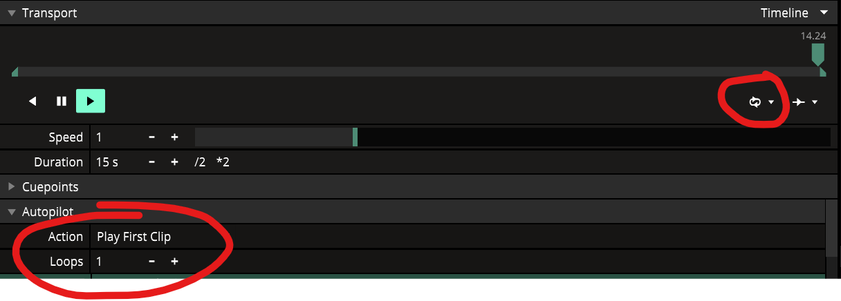

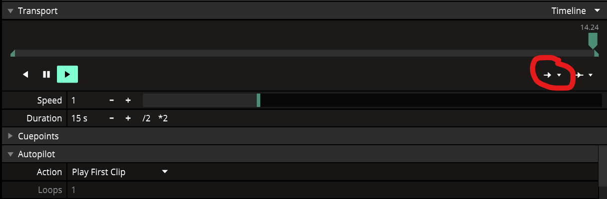

Solution 2 : have the clip set to play one and clear
