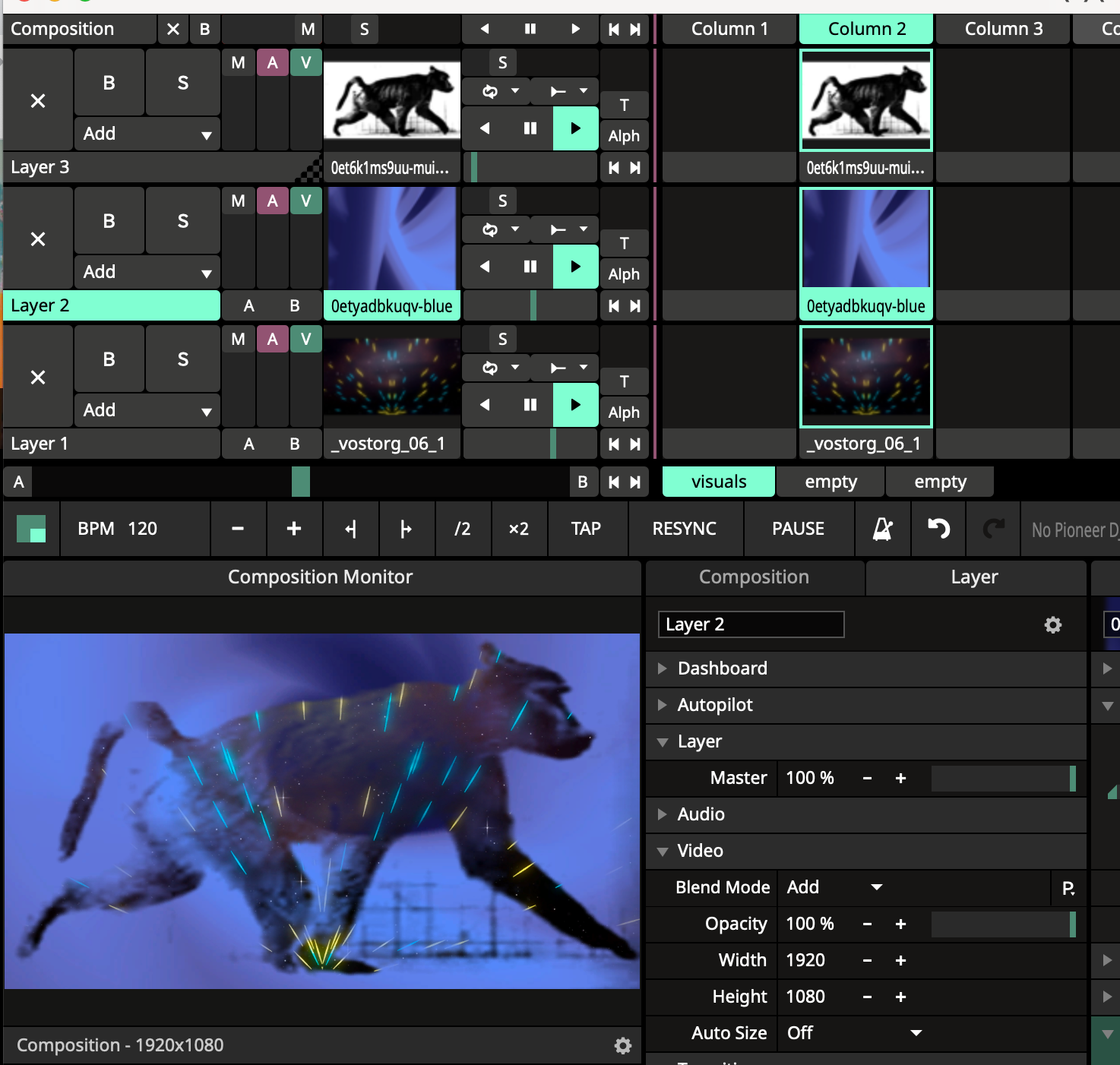

how about
play black content on layer 1
play white content on layer 2
set layer 3 to mask one below, and play your mask on that?
