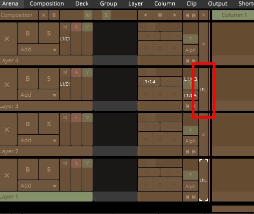

I am trying to map the 'connect specific clip' parameter to dmx on a MA2. I have 32 columns but when I turn the encoder wheel on the MA the clip selected is erratic and can never return back to the first clip in that layer. Has anyone else had this issue?

Set your encoder to ultra fine. Also as you add more columns, your float recall will change, so I typically keep 512 columns even if they're not all in use to help with this. Then just create presets for cuestacks and things should recall nicely.

Arvol wrote: Fri Apr 28, 2023 16:50 Set your encoder to ultra fine. Also as you add more columns, your float recall will change, so I typically keep 512 columns even if they're not all in use to help with this. Then just create presets for cuestacks and things should recall nicely.
Thank you that worked just like it needs to.
