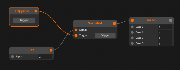

Trigger doesn't have a value. Toggle is bool, that's why it works.
To make a switch go to a pre-defined state, store that state/value to an int or bool, and use snapshot with the trigger.
