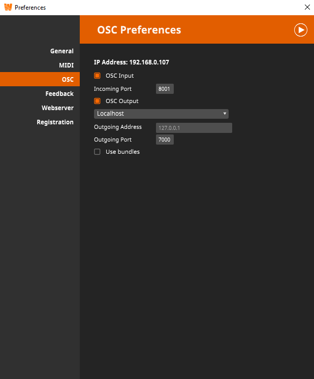

Yes, I've setup OSC settings both in Wire and in Avenue according to the attached pictures. Orange is from Wire and Blue is from Avenue. The sending of OSC messages works great when Wire is running, but stops to work once I close Wire (which I assume is the case when someone buys the effect from Juice Bar and installs it in Avenue). I've also updated my question above and added an example of what I would like to do.

When you run the patch in Wire, and then close Wire, you close the app which is sending OSC, so it stops sending OSC.
Sending OSC from a Wire patch running in Resolume, the Resolume OSC settings and interfaces are used.
That won't work directly to control Resolume itself via OSC, you'd need an app which bounces the OSC back.

When Avenue/Arena is running a Wire patch (with Wire closed), the OSC ports for communication should be set in Avenue/Arena settings. When running a Wire patch directly in Wire, the OSC ports for communication should be set in Wire settings.
